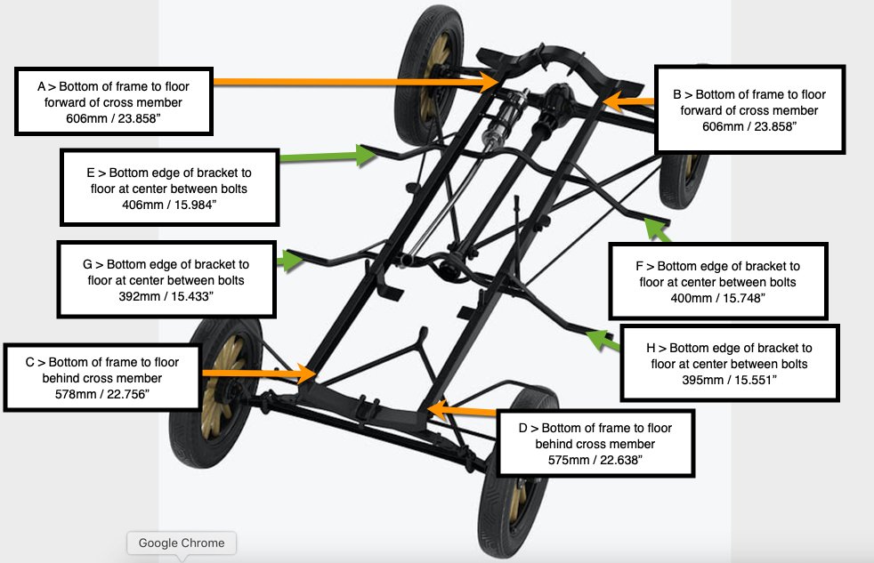

From the floor to the bottom of frame rails I get the following measurements:
Front 22 3/4"
Rear 23 55/64"
Additionally, the right front running board bracket measures 1/8" lower than the left one. I was thinking about bending it upwards to compensate. Bodywork is not my expertise but I suspect that would require heating the bracket to red hot. The frame has already been painted so maybe it'll be more practical to shim the wood spacer up and be done with it.
Can someone confirm their chassis height on a similar model?

I assume you are measuring a complete car, and not just the running gear, as pictured, without the body, engine, etc. Any and all weight added to the chassis will lower the ride height.

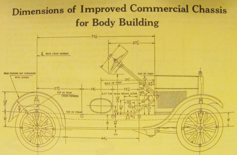

Here is a sketch of factory dimensions for the chassis only on the Improved Car, this may help some.
Click on image to enlarge.

Thanks for your input gents. It's good to know that the springs will settle in a bit after driving. I filed them down, leaf by leaf then painted them with black enamel paint with powdered graphite mixed in. They have a wonderful movement I haven't seen in decades (they hadn't been lubed for at least 40 years).
My concern with the height came about when I bolted a rear fender up to the trunk and saw how much room there was from the top of the tire to the fender (about 8 inches). It's true that some parts still have to be bolted onto the car so there will be a little more weight to pull things downward.
I searched for chassis dimensions drawing for the improved car but only found the one for earlier cars, so thanks for that Dan. That will make things easier to measure and check.
