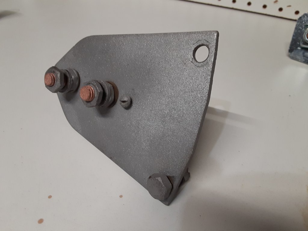

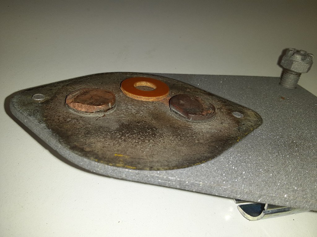

I am still considering restoring the 1927 starter switch. I have several questions and thoughts about doing it.
#1 I am thinking of using the insulation washers from the T5014 to replace the ones shown in the first photo.
#2 There are insulating washers under the contacts shown in the second photo, and I would replace those also. Actually, there are three insulating washers on the stud as shown in the third photo. The middle washer fits in the "hole" in the switch base plate. It appears to be in good condition. Someone said the contacts should be rotated 180 degrees, and I will do that.
#3 I assume there is an insulating piece under contact plate. I am pointing to it with the ice pick in the fourth photo. It might be "U" shaped and not flat. I don't want to get into replacing that. Any comments on whether or not it should be replaced? The contact plate appears to be "layer" and not a single piece.
#4 There also looks like there is an insulating ring under the end of the plunger rod as shown in the fourth and fifth photo. I also don't want to get into replacing that. Any comments on whether or not it should be replaced?

Here's a starter switch that was sitting outside for years on a rusting frame. I took it apart and restored it and it works perfectly. The original stuff was made of much higher quality materials all around. I would use the originals every time.

You want to take your Dremel tool with a sanding drum onto the contact points.

When replacing the fiber washers always remember the copper bolts HAVE to be in the center and not touch the sides of the hole in the switch frame they go through.The larger Ace hardware stores or any well stocked hardware store has fiber or hardened rubber washers that can be modified to have a good fit for the centering washer. You can carefully use a chainsaw round file to enlarge the center hole of the washer for a good fit and then carefully sand or cut it down if you have to on the outside. Take your time on the centering washer as it’s the most important. Then use fiber washers on either side and you should be OK.
Hope this can be of help.

Think about this. If that insulation should ever fail what could possible happen? The plunger is in effect completing a circuit: positive voltage passing through it to a metal housing grounded to your chassis while your the sole of your footwear (insulated material?) is pressing down on the plunger while your hands are in contact with the throttle and/or spark levers (grounded!).BLB27 wrote: ↑Mon May 09, 2022 9:16 pmI am still considering restoring the 1927 starter switch. I have several questions and thoughts about doing it.
Best to leave it alone or replace the plunger rod with some no conductive material.

Bruce, all this starter switch talk got me to spend a couple hours putting some together last night. Out of 4, I had enough really good parts to assemble 3 with some good stuff left over. These original ford starter switches used vulcanized paper insulators. There are modern things that will do the same, and better to be safe than sorry and have to redo it. Check it with a meter and that will tell you if in good shape.
Now, since starter switches are being discussed, I noticed something last night. On all 4 I had in front of me, the inner nut on the bottom was BRASS followed by a lock washer, then the cable ,and finally a STEEL nut on top. So FoMoCo in their wisdom used a steel nut to cap things off. Was it a $$ savings or because of wanting the nut tight? Perhaps tighter than a brass nut could be drawn before failing. If you laugh about the cost factor, maybe using a steel nut over brass saved a part of a cent…….take that part of a cent and multiply by millions, you have some real money! So, note the spot where the cable gets installed, and also the small FORD script proudly stamped on these nice starter buttons. Look close on yours, every one of mine has it.

You want the lock washer between the brass nut and the cable lug.

This is the same nut configuration used on starters. The top steel nut was copper plated.Dropacent wrote: ↑Mon May 09, 2022 10:06 pmBruce, all this starter switch talk got me to spend a couple hours putting some together last night. Out of 4, I had enough really good parts to assemble 3 with some good stuff left over. These original ford starter switches used vulcanized paper insulators. There are modern things that will do the same, and better to be safe than sorry and have to redo it. Check it with a meter and that will tell you if in good shape.
Now, since starter switches are being discussed, I noticed something last night. On all 4 I had in front of me, the inner nut on the bottom was BRASS followed by a lock washer, then the cable ,and finally a STEEL nut on top. So FoMoCo in their wisdom used a steel nut to cap things off. Was it a $$ savings or because of wanting the nut tight? Perhaps tighter than a brass nut could be drawn before failing. If you laugh about the cost factor, maybe using a steel nut over brass saved a part of a cent…….take that part of a cent and multiply by millions, you have some real money! So, note the spot where the cable gets installed, and also the small FORD script proudly stamped on these nice starter buttons. Look close on yours, every one of mine has it. 376E16A7-5802-456C-93BF-49BDC5785E9B.jpeg8BE48F5B-ED91-4E3E-8F54-8D30F4F87145.jpeg3B3AD655-F5FA-4EC8-A3C5-00F6590BC1F8.jpeg

Bruce. Good decision. You are doing the right thing by restoring and using the original starter foot button. I doubt if there is any insulation in the upper half of the button. The steel shaft inside the plunger is riveted to the button cap, which is connected to the two contacts and making constant contact with the steel casing of the upper portion, so if there was insulation, it would not stop the contact of the 2 steel surfaces (the button shaft to the steel casing), so I would not bother with that or worry about it. You may want to consider bending the tabs of the upper contacts down (toward the lower contacts) a little to introduce a little tension that may have been lost over many years of use, but don’t bend too much. You don’t want it to make contact while still in the up position.
I have noticed that you seem to be replacing a lot of good parts. If you believe that just because a part is old, it should be replaced, please rid yourself of that notion. In most cases, original Ford parts are much better than new repro parts. The original parts were made on the assembly line by experienced Ford workers according to the original Ford design, using better materials and there is something about using the original parts that were installed on the car on the assembly line, by Ford workers 95 years ago and that have traveled with the car from inception, thru some of history’s most important events to now that is very appealing to me and many other T guys and gals. Just something to consider.
