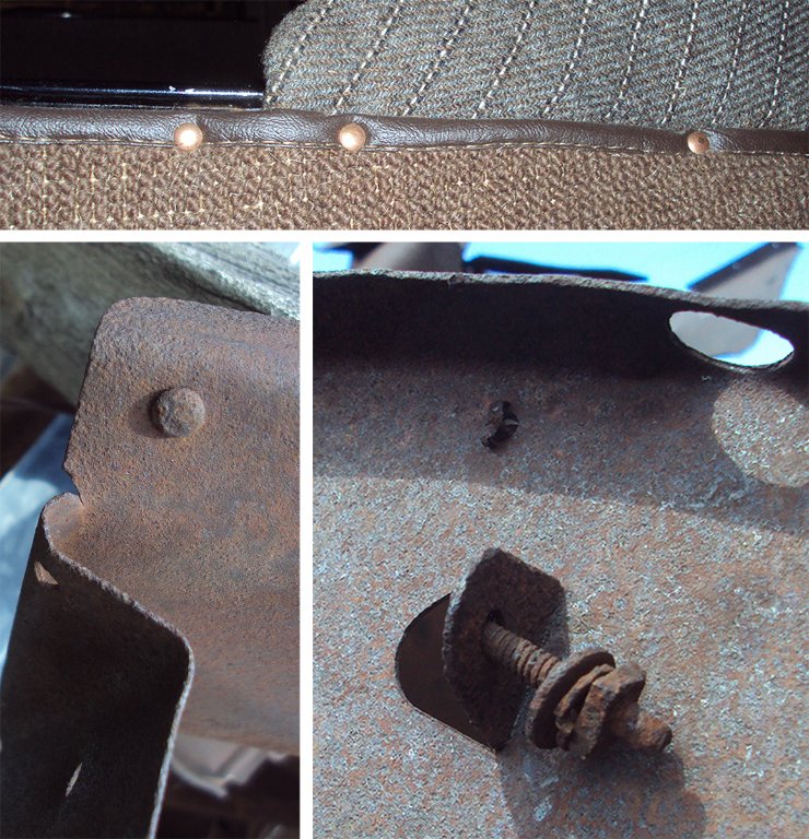

Does anyone recall how to fasten the carpeting for the seat riser?
Re: ‘25 Interior Installation
It's looking good Tad.
Your metal seat frame (Riser) should have a number of holes for rivets as shown in the first picture here. They used a steel split rivet. I have shown the copper plated ones I used in my Tudor. I can't remember if they came with the kit. Mine are exposed. I don't know how else they would have done it without showing. Maybe someone knows more.

Tad,
On the '26 Fordor (in an earlier post I incorrectly said that it was a '25) that I reupholstered, there were small holes, about .125 in diameter located near the top and the bottom of the seat riser.
Since 3-M Yellow 77 spray adhesive did not exist in 1926, it was determined that the holes were used to place grey colored split rivets through the carpet and into those holes in the seat riser to hold the carpet in place.
As I mentioned, my father was an upholsterer and I just happened to have those rivets. They were a good match to the color of the carpet and, provided that by starting in the center and working our way out to the ends, we pulled the carpet cover tight before piercing the carpet with the rivet at each hole location. It turned out very nice.
As for the availability of those rivets, I know that split, flat head rivets can be found. Finding them in matte grey color may be a challenge but, they can always be painted any color you like.
Hope this helps.
Mike.
Hope this helps.
Mike.

Guess I should have read Rich Eagle's post above. Seems like we both are on the same page about the rivets.

Thanks for the confirmation Mike.

I can't express my appreciation enough for all the information you have helped me obtain. Thank you Mr. Eagle and Mr. Spaziano!
Will use some raven split rivets I have to install the seat riser carpet.
