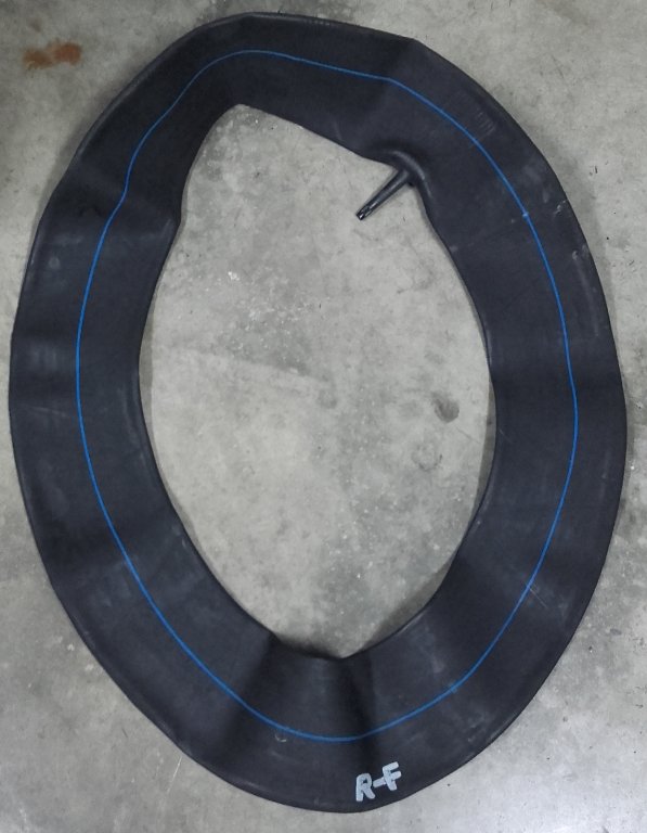

After new tires and tubes were mounted in 2015 my car has yet to be driven out on the open road. The pressure drops from 32 psi to 19 psi in 30 days. This seems excessive although someone once told me that they will hold pressure better after they have seen some use out on the road.
One of the tubes had a leak from new (purchased from Coker through a local supplier) but the supplier did not ask for any detailed explanations about how it happened and replaced it right away.
I don't know if tire tubes have a distinctive style or look to them which would allow their brand to be identified, but after reading on the Forum that some makes are prone to splitting I would like to know if anyone with some experience could identify these tubes as "likely suspects".
Here it is just out of the package: Here is one of its brothers posing with the rim and tire: Here is the soapy water giving away the leak: My intentions are to finish the restoration of my car this year so things will need to be in perfect working order in the next months. I would hate to throw away unused tubes but if the probabilities of a blow-out are high I would rather know it now and look into getting something else more reliable.

Do the Hartford tubes have a blue stripe running the perimeter like this?

I can't answer all the questions, but I can tell about the three clincher size tubes on the shelf in my shop. On the Custom Classic tube the name is molded in the rubber. It has held air for over a year, so it may be OK to use. I have a Hartford tube with the brand name painted on, also holding air. The third tube has no name, but a blue stripe. It has a satin finish, shinier than the other two tubes. They have a matte finish. It has lost air in just a few weeks, so I will change the valve core and see if that's the reason. Blockley's website shows their tube with their name molded in the rubber.

The Hartford Tubes I have seen do have the Blue line plus their name in bold letters. To me, that’s a great sign if the manufacturer puts their name on it as they have confidence in their product. Blockley do exactly the same with both their Tyres and Tubes.
