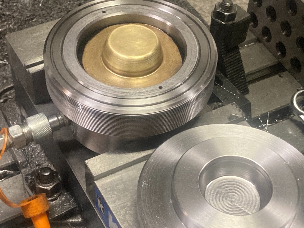

Re: What is it...?
Spare “time”...?! What is this spare “time” you speak of...?
Yesterday was a rare occasion when the wife was at work, the kids were with nana, and work was really quiet. I had 8 uninterrupted hours in the shop, and was able to finish the forming fixture and make bout a dozen parts. Only the 1 shown above turned out without popping, but is most likely too light as the material stretched really thin. I hope to try smaller blanks to allow the skirt to draw into the die, and hopefully this will mean less annealing steps too...
The hydraulic forming creates pressure in all directions and on all surfaces, unlike conventional stamping. So the part is exactly the same size as the die, and the resolution is fantastic. If I can get the annealing steps and blank diameter figured out, I suspect that a new float will be easy to make... someday!

Do you have an air bleed hole, Kevin? Do you anneal a couple times? Copper or brass? Looks great, you’ll get it.
Topic author - Posts: 1617
- First Name: Kevin
- Last Name: Pharis
- Location: Sacramento CA
Re: What is it...?
I’m working with brass, and after so many failures I annealed the successful part about 8-10 times! Probably more than required, but I was determined to get a fully formed part. I started with .020” sheet, and the material tends to fracture when stretched to about .008”-.010”. This one finished at .006”, and was obsessively annealed toward the end. I haven’t been able to form a full hemisphere yet, and I suspect that getting the skirt to draw into the die will be necessary for success. Drawing the skirt into the die should also mean less stretching, and so more consistent material thickness and less bursting!

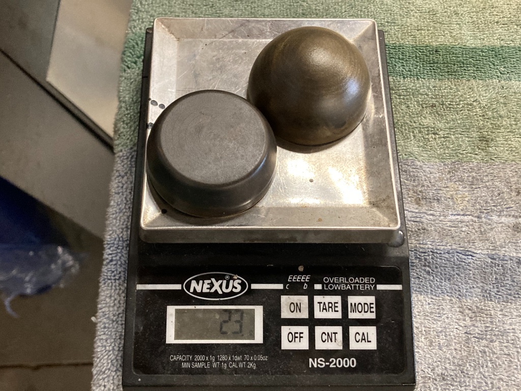

I ordered some special vibration resistant “no clean” solder that arrived today. Worked like a charm! I am on size, on weight, and floating... at the right height!
Here is a spun float compared to an original;
And here is the new hydraulically formed float compared to the same spun float (not sure where my original went);
All shined up;
All shined up;

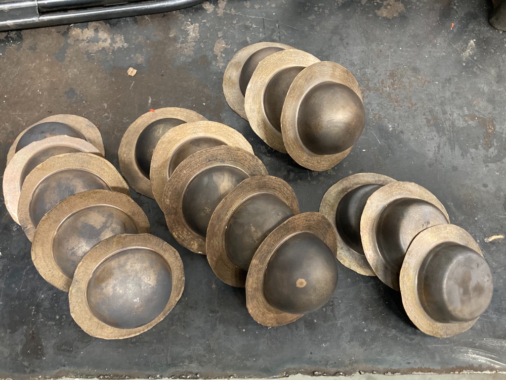

Must be doing sumpin right! Didn’t have any failures this afternoon, and so will yield 8 complete floats. I switched from MAP gas to propane, and am no longer overheating the brass during the annealing steps. This combined with smaller forming increments is producing very consistent parts.
I trimmed the first few by hand... and it was tedious! So am now scheming on a fixture to trim all these more reliably. The heavy lifting will have to wait tho, I have to get the rebuilt Ruxtell painted and installed in my ‘15 for a tour next month. Have a Winfield S-AA updraft to replace the U&J carb too...

Looks like you’ll need to build some more carbs to use up those floats.
