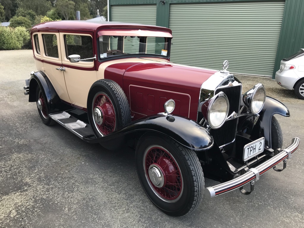

Kevin wanted me to share a picture of the beastie he’s looking at & considering to purchase
