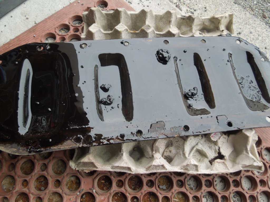

I found a few lumps when I dropped the pan
[attachment=0]DSCN2754.JPG[/attachment]download/file.php?mode=view&id=129305
Bit of white metal I guess.

Re: I found a few lumps when I dropped the pan
What is it like when you rub it between your fingers? Hard, or mushy? Silver when washed or black all the way thru?
- Posts: 7917
If you have lumps of white metal (babbit) that large in the pan, I'd think you'd have one or more bearings completely destroyed. That looks more like lumps of carbon to me. The oil residue looks very thick and black. Thick layers of carbon can form on the underside of the piston crowns under some operating conditions, and chunks of it can dislodge and fall into the pan. Washing the lumps in clean solvent and then crushing them on a clean hard surface will reveal what they are. Carbon lumps will be black and crumbly all the way through, while white metal will have a distinctly metallic appearance and will be malleable. Running dirty oil or poor quality oil can contribute to carbon accumulation, as can chronic late timing, poor fuel quality, and chronic overheating.
Thanks guys.
I found this several months ago and by memory the lumps were hard but I kept a sample so will try and clean it up and post my findings.
Motor hasn't been neglected in my ownership, oil has never got old, never over heated or ran with timing not set correctly but can't speak for the previous owner (deceased) so could have built up over years.
The bottom end is pretty noisy (that's why I took the pan off), tightened up the bearing caps and she is still running but maybe one day it will need a doctor.
Jeff you may be correct. I crushed the bits I had left and they crushed up to dust so perhaps its carbon.
I have found similar carbon clumps before. Just check everything over and put some fresh oil back in, shouldn’t be a problem.
That's carbon. I would suspect that it formed as a result of poor maintenence and/or poor quality oil, perhaps aggravated by overheating. It's likely that the underside of the piston crowns are caked with it. It's possible that areas around the exhaust ports behind the valve covers also accumulated some heavy deposits. The heaviest deposits will be in areas that normally run hottest, where the hard, baked-on carbon forms, and in areas where detrached loose chunks accumulated. I would remove the pan cover and clean as much debris out of the gutter around the cover opening as I could reach, and I I would install a transmission cover screen. I would then add 2 1/2 US quarts of 10W30 detergent motor oil and 1 US quart of Marvel Mystery Oil. I would then drive the car at moderate speeds for trips of 10-15 miles or so. Avoid high speeds and hard pulls in any gear. After the first trip, I'd check the transmission cover screen for debris and clean as necessary, and I'd check it often afterward, and I'd keep the oil level up. If the screen has sigfnificant amounts of debris, I'd also remove the pan cover and clean that area. If the oil quickly becomes black and thickens, I'd change it again, and again remove the pan cover and check for loose debris. (The alternative to these laborous, but inexpensive procedures would be to remove the engine for cleaning and inspection, and likely overhaul) Running the car for 10-15 miles, then immediately draining the oil into a clean container may help remove additional debris that reaches the pan sump. Let the oil settle overnight, then pour it throuugh a screen and replace it in the engine , if it's reasonabley clean. The idea is to get as much loose debris out of the engine as possible. A clogged oil pipe is another concern. See the Ford manual for cleaning procedure.
This is just a guess. Someone else who has more experience with this might confirm. Many years ago I was told that in an old engine which has been continually run on non-detergent oil the sludge builds up on the parts and if you don't know what kind of oil has been used since the engine was last rebuilt, to use non-detergent oil. The reason they give is that the detergent oil will loosen up sludge deposits and suspend it in the oil. With the splash oil system and dippers in the crankcase, and no oil filter, those deposits will get in the oil and settle in places such as the dips or in the bottom of the crankcase where it will be thrown around and can even block the oil pipe inside the engine.
Pretty normal on an old engine. That stuff generally forms on the inside of the piston and then breaks off and goes everywhere. When I buy a car, I pull the pan like you did and then wipe everything down with a bunch of shop rags...everything I can reach, with special attention to horizontal areas like where the horseshoe(s) fit. The crud you pull out will amaze you. One of several benefits is that future oil changes don't go black instantly and you may find the oil stays clean a lot longer. You'll be a lot less likely to plug or slow down the oil feeds to mains and everywhere else without those black clumps accumulating everywhere....it's just burnt/carbon
