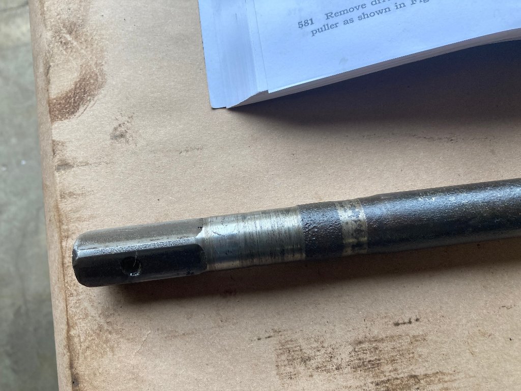

Getting into rebuilding the rear axle on my 1927 Touring, took the drive shaft apart and there is a modern bearing in the spool, not sure what the part is called, and no roller bearing, whats going on there.
I need new everything, drive shaft, roller bearing, spool, pinon gear, the only thing that looks good is the thrust bearing, what is a good alternative to replacing the bearing and spool if I can't find original parts, Texas T has a Pinion Bearing Cartridge and Drive Shaft Front Roller Bearing Kit that I could use with my spool or I have seen other options from Texas T and Model T Ranch or should I just replace the bearing that's there and call it good.
I think I've read that using the original bearings on the axles is preferred as they are more forgiving than new modern bearing but I don't know if that is true for the driveshaft.
What are your thoughts?
Side note: What was the Fun Projects pinion bearing I've read about?

The replacement Hyatt bearing is no good. Thats a solid roller as opposed to the original rollers, a wound spring.
Thats an interesting ball bearing modification you have. Have not seen this exact mod. I am a fan of going with all original parts.
I do understand the modern replacement taper bearing units work quite well & have no objections.
I let others sing their praises.

Birdhaven bought both Texas T and Fun Projects. They market all items under the Texas T Brand / web site. So the T2587 • '22-'27 Pinion Bearing Assembly Kit is one designed by Fun Projects. The Forum has responded with many likes from those not overly concerned with non-original hidden parts.
The drive shaft may still be usable all depends on how deep the marks are on the u-joint end and its OD of the shaft there. Same is true on the for the OD on the other end. Texas T has instructions for their pinion bearing assembly http://www.texastparts.com/mm5/manuals/T2583-AB.pdf
The Forum comments on the Front Roller Bearing pointed out more questions on its need than the original. http://www.mtfca.com/discus/messages/17 ... 1319985782
My guess is that your pinon spool appears to have been an early design by someone similar to the Pinion Bearing Assembly Kit
Removing the drive shaft inner sleeve appears to require a lot of effort. That may prompt one to get a new drive shaft aone

Have you measured the diameter of u-joint end of the D/S? If not worn too badly, it can be cleaned up & an undersized bushing made. I find if there is more than .008" - .010" wear, you need a new special made bushing or D/S.
There is the possibility of crushing the new bushing to make the I/D smaller to compensate for excessive wear. Same way one can refurbish triple gear bushings. I have not needed to do this for a D/S bushing yet, but have had great success on triple gear bushings..
All this assumes your pinion end is still in spec.

Some wear in the shaft by the bushing at the U joint end can be compensated for with an undersized bush, but it will require that the square end over which the U joint fits will require machining. The corners of the square must be relieved for the shaft to pass through the undersized bush. It may also mean that a shoulder on the worn section of the shaft needs to be turned off as well.
