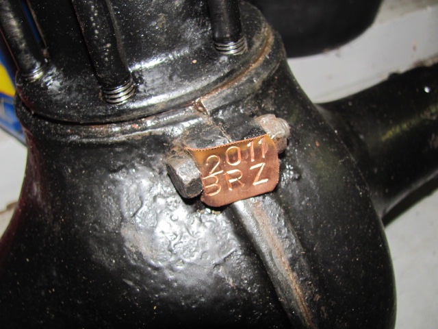

You may pass forward your 'pleasant surprise' if you make a little tag or plate and bolt to the rear axle housing, let a future owner know that news. I do.
