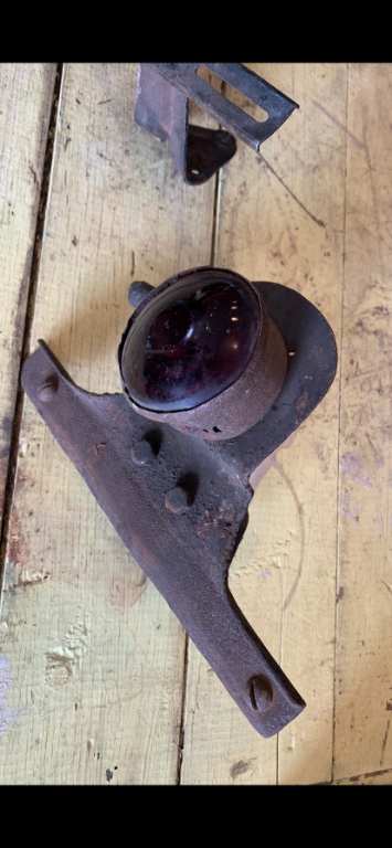

Looking for the 26/27 stop light bracket, circled. I have all the rest.

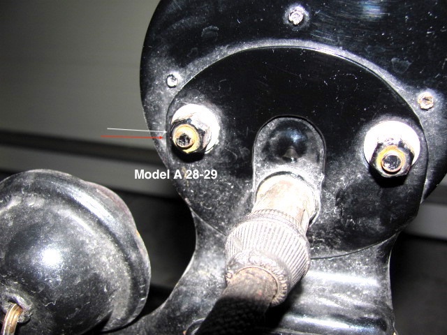

Jerry
Those 26-27 Stop +Tail license brackets are rare as hen's teeth.
So I fab'd one using the repop Synders 28-29 drum license bracket, cut the sides away, and drilled hole and cut straight sides to make that 'oblong' hole for the lamp socket and to clear the rear lamp bump. The sides of the 28-29 Model A bracket are narrow, but just enough 'meat' to drill holes for the nuts to secure the lamp's studs. Works, looks 'almost' authentic
ORIGINAL
WHAT WAS USED
RESULT

This is a great option over the unobtanium original piece.

Great suggestion! Thank you!

So this is a 26/27 tail light bracket. I see from the picture that the one you are looking for is a bit different than mine. I didn't know they made two kinds. This is not what you are looking for is it?
- Posts: 5111
Re: WANTED: 26/27 Stop Light - Bracket Only
No. He's looking for the bracket for the accessory stop/running light. There is no lip to mount the can & the back is larger.

The Ford accessory stoplight and license bracket is not the same as either one of the two Dodge styles that were made. Study the picture that Jerry posted and then, compare it against either one of the two Dodge brackets or a 28-29 A drum taillight bracket. Close, but no cigar. To the untrained eye, one can be fooled easily; be careful. The correct Ford bracket will have an oval shaped hole in the bracket where the back of the light socket/wiring plug extends through the bracket. The oval shaped hole will be wider at the top of the oval, than at the bottom, if I remember correctly. A lot of other "look alike" tail light brackets will have only a round hole for the socket to extend through. The good thing is that if authenticity is not your bag, either one of the two Dodges can be made to work easier than modifying a reproduction Model A Duolamp bracket. The stoplight itself bolts right to the Dodge or Ford bracket, but to bolt the Dodge bracket to a 26-27 T tail light stanchion, the holes in the bracket must be modified to match those in the stanchion. How do I know so much, I've done a few. I, even, tried to modify a Duolamp bracket like Dan Treace did; never again. Dan how did you find the metal that the reproduction Duolamp bracket was made from ? I ruined, broke and dulled, drill bits and used up so many grinding discs for my Dremel tool that I had to go to Lowe's to buy more. I swear, that was the toughest metal I've ever found on a pressed steel reproduction part. By the way, the Ford and Dodge stop lights were made by the C. M. Hall Mfg. Co. Huppmobile and a few other more expensive makes used there own version.Jerry VanOoteghem wrote: ↑Tue May 03, 2022 1:43 pmLooking for the 26/27 stop light bracket, circled. I have all the rest.
