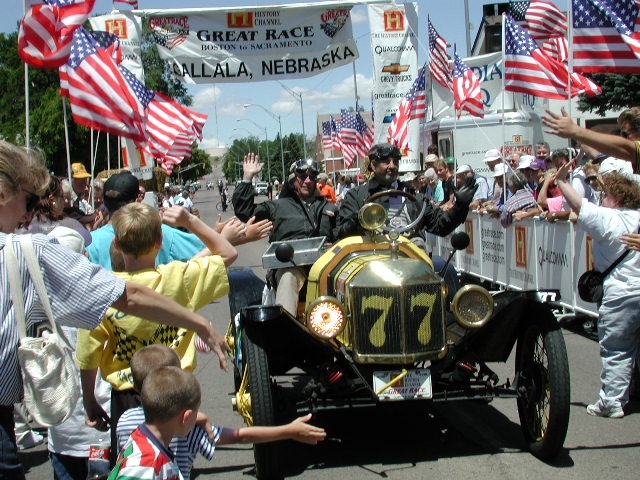

Another reason I went with Plexiglas was the lightweight . My monocle frame was the repro light alum. frame, that I painted black instead of polishing. It used a simple bolt and nut arrangement for the hinge adjustment, the bolt shared the same duty as clamping the frame to the column.
Even with the Plexiglas, at road speed of 25mph or so, had to really tighten down on that hinge nut to keep the monocle from coming back due to wind force and hitting my hand and the steering wheel. :shock:
Can't imagine that flimsy frame holding a heavy circle of glass without some sort of engineering to the hinge.
