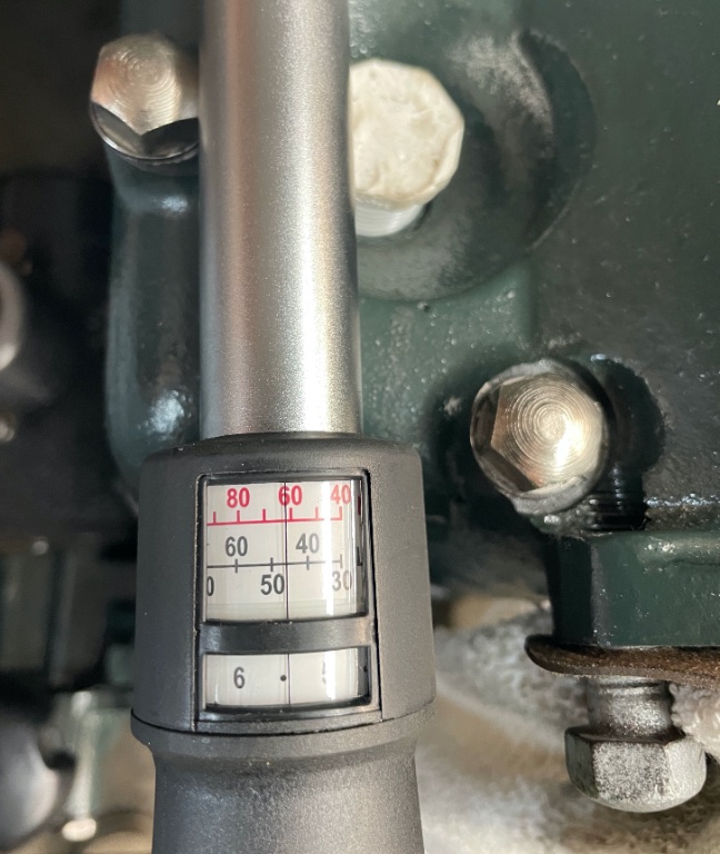

I'm following this topic with interest. I bought one a few months ago as a new Hobby Touring 1926 which I now want to get fit again. The head was dismantled and some threads torn out. I repaired this with Time Sert.
But then I was very surprised at the brief engagement of the cylinder head bolts in the block and then I discovered a number of posts about this problem in the forum.
So I rethreaded the block down to the bottom of the holes and got new, longer head bolts (I think these were from a Ford Capri).
These screws now grip 0.87" (22mm) in the engine block.
But they have a strength of 12.9! Is that too strong? Do I have problems with that? Thank you for your opinion.

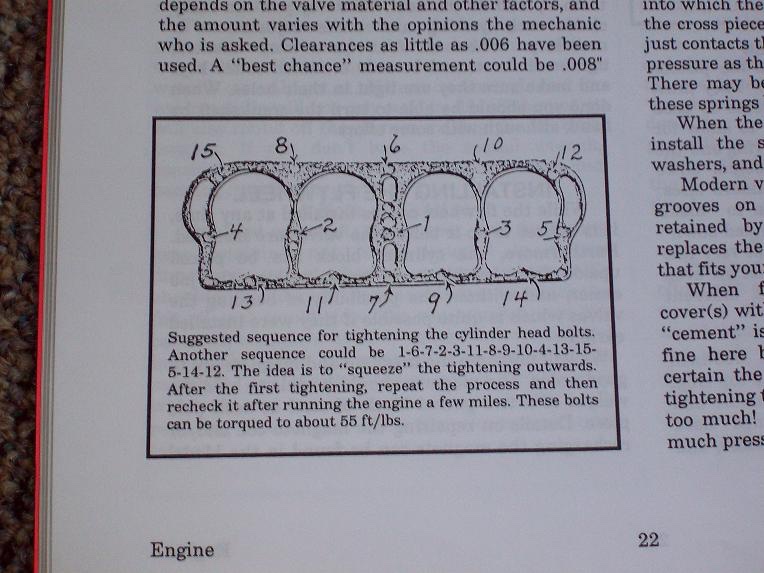

Before bolting down the head, chase the threads with a tap and blow out the holes with high pressure air. Using duct tape, tape over all block holes (cylinders, valves and water jacket holes) to prevent debris from bolt holes to fall into the holes. Once each bolt hole is blown out, screw in a bolt to keep debris from other bolt holes from going into the clean bolt hole.
When bolting down the head, to avoid cracking the head, be sure to alternate the bolts. Tighten down each one until finger tight, then alternate the tightening in 10 ft./lbs. until each bolt is torqued 50 to 55ft./lbs. Run the engine until hot. When it cools, torque 50 to 55ft./lbs. again alternating the tightening process using the attached diagram. Jim Patrick
- Posts: 4684
Re: Head Bolts Stretched - Studs?
This could account for a case where the head bolts were torqued to 50 ft lbs and the gasket blew! This was after the head had been re-surfaced, so the bolts would have needed to be turned down just a small amount more than before resurfacing. I am about to replace the gasket which blew, and will check out and maybe replace the bolts this time, because gaskets are hard to come by.
Thanks for the feedback
Some time ago I installed the cylinder head and the screws as you described. To look authentic I lathed the screw heads and painted them black as shown in the pictures. Thanks to the longer screws, I now have a very good grip in the engine block.
My only concern is the tightness of the screws. As I further informed myself, the European standard 12.9 is stronger than grade 8. I hope that doesn't cause any problems with the threads.
Greetings from switzerland

I really like what you did with the heads of the Class 12.9 bolts. Nice!

I’m a bit curious about the 12.9 grade screws, as all I have ever seen in 12.9 is metric thread hardware. The Ford blocks I have encountered here in the states are threaded 7/16”-14, are globally produced variations equipped with metric hardware...? Metric grade 12.9 is basically equivalent to grade 9, and are common grades for all socket head fasteners.
7/16”-14 (.437” x .0714”) is close to M12x1.75 (.472” x .0688”), is it possible that this block was tapped out to this slightly larger size...?
- Posts: 128
- Joined: Sun Jul 10, 2022 12:16 pm
- First Name: Beat
- Last Name: Betschart
- Location: Trachslau Switzerland
Hi
No, they are the original 7/16"-14 threads in the block.
When I looked around, we often found inch screws with a European standard. I could imagine that these screws are made in Europe and are therefore labeled with the European standard.
The Ford Capri from which the screws come was produced in Germany.
Greeting
Greeting
