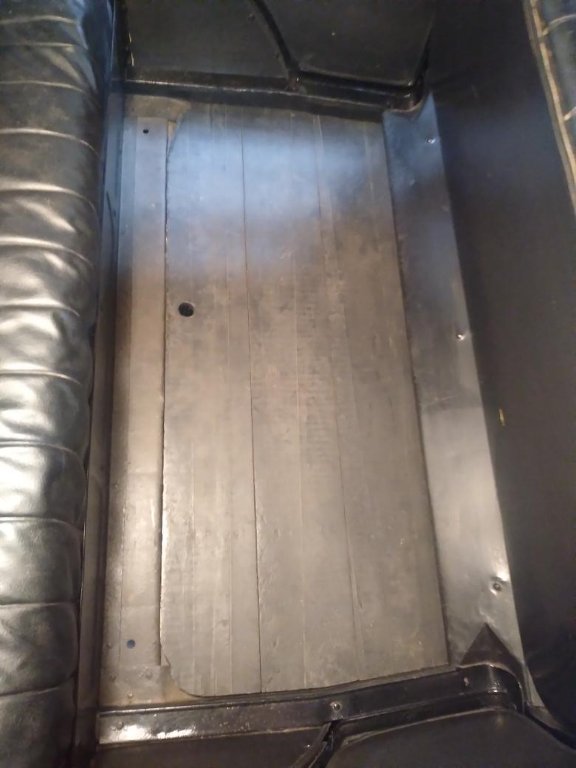

Mopar man... I believe your wood floor strips were not cut wide enough. They do not rest on that inner flange all the way around. I had pictures of my front floor on a 26, the rear floor boards should be wide enough to fit inside the flange all the way around.

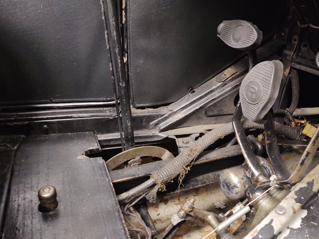

File pictures.... Front floor area

Those floorboards are not right. Front floorboards should be 3 pieces, upper, middle, bottom. Boards overlap so no gaps between them even with shrinkage. Front floorboards must fit well so they do not bind up the pedals.

Jeff... I only left the one board on the picture to show that the board rests on the outer flange of the body metal if I put all the boards back in position and took a picture would you really know that they're resting on the flange?..... The board and the picture is a correct one... The board is wide enough to rest on the body flange and also on the flange that goes across the the seat area.

Jeff.... These are not floorboards from a floor board builder... These boards were factory supplied when the car was built. Five boards that are tongue and groove . Ford re-used the wood from shipping cartons that he received and cut the wood to what had to be used in cars such as seat frames and floorboards....... Our present Ford suppliers maybe selling plywood replacements that you are confused with as original style floorboards.

Jeff... I do not have you confused with Robert Gavoni. Gavoni posted showing rear floor boards that are not wide enough. I posted pictures of front floor boards which were factory issue when the car was built., Showing how they were wide enough and rested in the body flange for support, just as the rear floor boards should fit. I'm sorry I do not have pictures of the rear floorboards, but again they should fit width and lengthwise to be supported by the body floor flange. ... And by the way on the front floor boards where it does angle up , my boards are supported by two metal braces underneath , the same as your Ford research center photo points out.

.....plus, Jeff, The "finger hole " that you refer is not an aid to remove the boards but rather for the starter switch to come through.

Post by Moxie26 » Sun Jun 05, 2022 1:47 pm
File pictures......self explanatory
