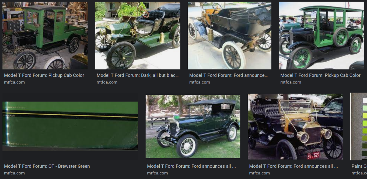

Thanks for your input do any of you have pictures of model Ts painted in Brewster Green?

Here are some links to Brewster Green with pictures and discussions of Channel Green and Commercial Green
http://www.mtfca.com/discus/messages/59 ... 1464567820
http://www.mtfca.com/discus/messages/17 ... 1319559906
http://www.mtfca.com/discus/messages/41 ... 1394110592
http://www.mtfca.com/discus/messages/59 ... 1465736176
