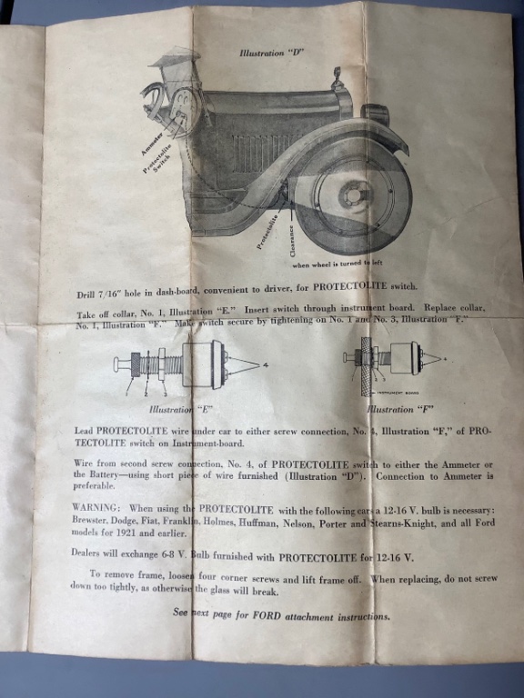

PROTECTOLITE accessory road light
Here is a nifty NOS accessory. They even mention the lowly Ford.

Re: PROTECTOLITE accessory road light
Nicely made, but why mount it down on the fender? It looks to me like road debris, mud, horse emissions, etc would make short work of it there.
Took care of that problem. Just mounted on the merc to the cycle fender mount. It’ll turn with the wheels now.
I’d have to agree %100 with you on the original mounting spot. Even with modern roads, it would take a good beating!
