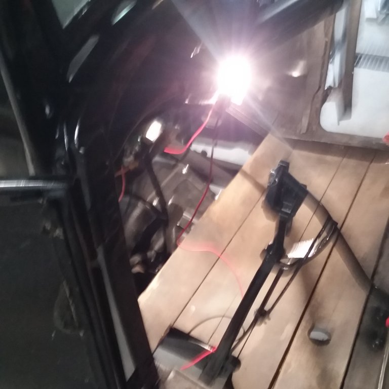

Make up a test bulb rig using a headlight socket and an 1156 bulb. One lead to mag post. One lead to ground. The bulb should light just by cranking the motor over. It should glow brightly at idle. And glow brilliantly at at very fast idle, to a point where the bulb burns out.
