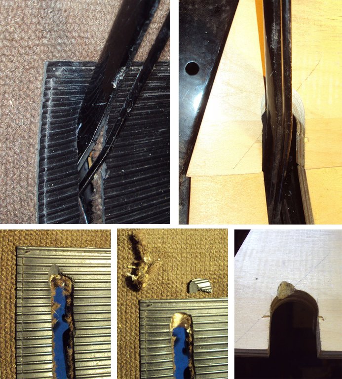

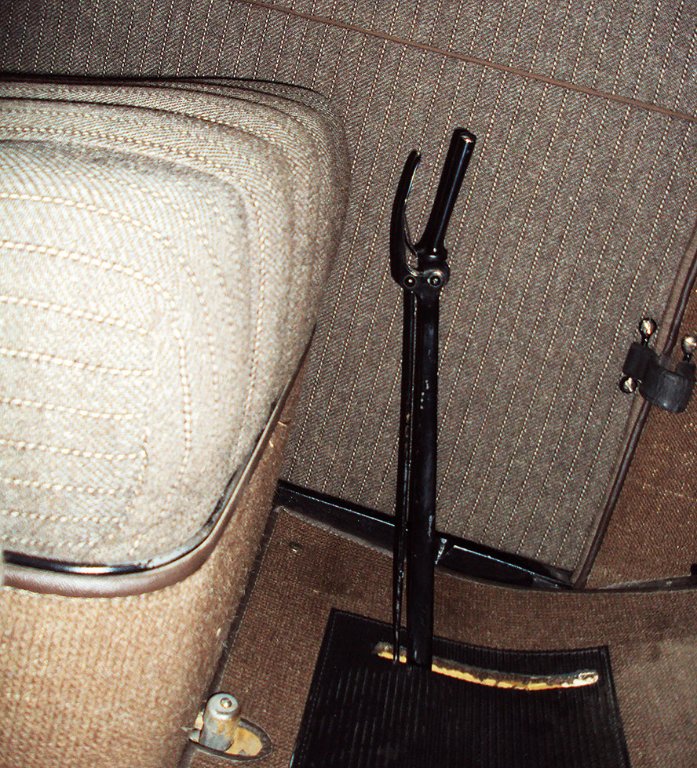

I also discovered that the floorboard was stopping the brake handle from making its full travel of disengagement. Filing the hole a bit longer solved this problem. I trimmed the carpet to match.
Now, with the brake lining worn more round, the shorter rods and the hole in floorboard enlarged I can achieve locked brakes before the handle meets the seat and no drag in the released position.

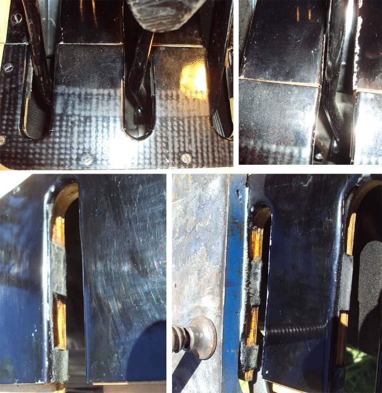

While the floorboards were out it was a good time to address a reverse pedal problem I was having. The pedal would sometimes stick in the engaged position and not release without pulling it back with my foot. Due to the cam action it was contacting the floorboard trim plate in the engaged position. By clamping a plate firmly to the floorboard I could tap it closer and give the pedal more clearance. Previously I had been putting grease on it to keep it from binding.

I took pictures of the toasted floorboard and carpet. They don’t get hot enough to burn but have a nice brown from the heat duct.

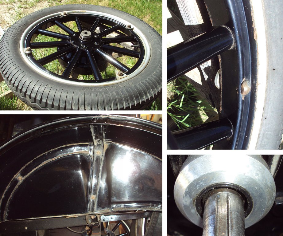

Having the rear wheels off gave me a chance to thoroughly clean them and the underside of the fenders. These were painted with Dulux Super Black 22 years ago. I believe it has held up well. It has been driven in Winter and subjected to the de-icing agents. I used no hardener so it is a little subject to scratching when washing. No wax has been applied. I wish Dulux was still available.
Included is a photo of the axle seal where the shim or the key has worn some rubber away. It still seals most of the grease/oil in.
