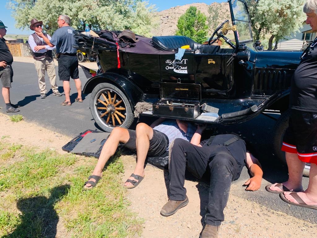

Day 15, 21st June 2022, 301 km / 188 km today, in total more than 3.400 km in the States
From Lincoln to Broken Bow, Nebraska.
Flat landscape, agriculture, rail road beneath the roads.
Chance of rain, therefore we closed the top.
See also Ron’s update.

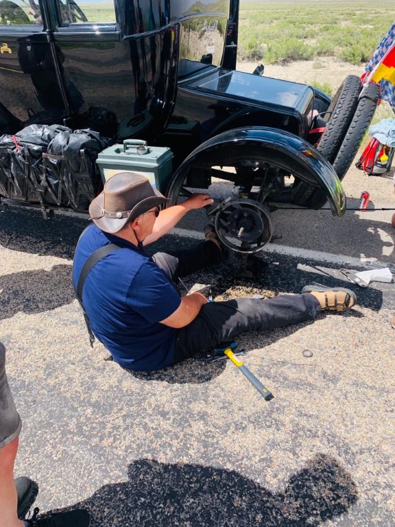

Ignition issues on Harald’s and my car, after cleaning the spark 3 (Harald) and the new day timer (me) they worked again like they should and as they did before.
Later again a flat tire / Harald’s T again

Harald has flats in his tires and they have more than 60 psi.
5 flat tires because of too hard old tires on the rear axle, tire turned around and valves are broken. 2 leaks at the valve top, where rubber and metals come together, nails…

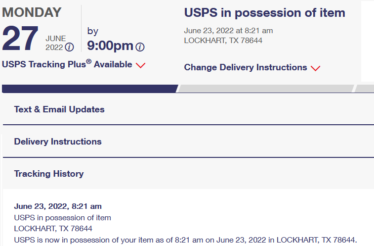

George Lugs were delivered this morning to Ford in Diamondville. I tried to contact them, but did not reached/found the right person, hopefully the parts will be still there, till we will be there - that should be on Wednesday afternoon.

33 miles before Kemmerer we had a big problem. Gerhard‘s rear axle bearing disappeared
Harald an Stefan found a way to enable Gerhard to drive his car to Kemmerer.
And we called Ron Horton, from a place north of Odgen,) who offered me here in the forum to call him, if I have a problem….
And, it’s unbelievable, he made 100 miles to bring Gerhard the parts he needed.
He did not want to have anything for that, and if was also unbelievable to that he was older than 85 years.
He stayed in Germany till 1968 in Idar-Oberstein which is only 23miles from my home. Again, Unbelievable!
We tried to fix Gerhards rear axle, but it did not work without heavier tools.

This morning, day 24, June 30th 2022, we finished the repair of Gerhard’s rear bearing at Frontier Ford workshop in Diamondville.
Our thanks go to Rex who allowed us to use the space and additional tools for free.
The reason for the failure is not clear, but we did not find any grease in the bearing.

Bernhard, thanks for the pictures, I’m not sure what I’m seeing in the pictures but it appears you took the drivers side axle housing off and then grinding on the axle shaft. Did the axle shaft break? Is that a coupler on the axle shaft to bring the axle shaft together? Was there a grease cup or zerk fitting on the axle housing for the Hyatt bearing to get grease? Is the bearing sleeve put in correctly so grease will get into the bearings? On A trip like the group is on I would think you’d need to grease much more frequently but that’s just my opinion.  I’m glad the group finished the repair and are back on the journey with no problems today. Best John

Hi John, the shaft was okay. There was installed a modern bearing like you could find it for nearly 200 USD each at Langs. No original rollerbearing.
We could - with some effort - remove this modern bearing and the sleeve with my sleeve puller. But we saw that still something was inside the axle and so far outside that there wasn’t enough space to insert Ron‘s roller bearing.

Day 25, July 1st 2022, not a real driving day as we decided to go for site seeing to Salt Lake City.
From Ogden over Pleasant View to Salt Lake City, 144 km, 90 miles.
First we went to Ron Horton, who offered is help here on the forum and brought the necessary parts within a few hours from Pleasant View to Kemmerer, more than 100 miles one way two days ago. Gerhard car was yesterday back on the road because of Ron support.
Ron, his wife, his son and a friend expected us and showed us Ron’s very nice Model Ts. My wife’s favourite is his Speedster, Ron‘s favourite is his 1923 Roadster.
On the way to Salt Lake City Haralds right rear wheel broke down, because of the loose spokes. We had to exchange is against the new spoked wheel including exchange of the break drum.
After repairing this, a strange noise could be heart.
Removing the inner breaks did not help.
We found Wayde from Lake Welding Services in Farmington, who grinded the too long screws to the right length. One problem solved, but the wheel got stuck.
We inserted additional shins and now everything works.
All done in his workshop, he did not want any money, but he gave us cold drinks and the chance to clean our hands…

So your saying that Henry designed the rear axle to use a Hyatt bearing to run without grease?
- Posts: 2920
- Last Name: Hjortnaes
- Location: Men Falls, WI
Re: Coast to Coast, Part 2 - the halfway point
Frank,
You must have missed Bernard's post on July 1, where he states a modern bearing was installed on the car, not the original roller bearing. I do not believe you can add grease to the modern bearing.

But about 2 miles before entering the I80 I recognised a strange sound from the front part of my car. I stopped and saw the mess, the „new“ pin of the crankshaft pulley was missing (installed 5?days ago in Lusk) and therefore the fan cooling wasn’t possible.
We didn’t have the required parts with us.
Therefore we needed to drive to a hardware shop of a workshop.
We first drove on a back road a few miles to the West, but nothing was to find. Then fast but not too fast back to Grantsville.
We did not realise the tension pin solution, but we installed a new handmade Pin with 2 cotter pins.
This took us nearly 3 hours. But we had again a temporary solution.
The I80 was later very crowded and we had heavy side winds.
Furthermore the last car in our order, the Yellow one, had two extrem situations, when trucks recognised to late the slow cars and overtook them on the hard shoulder and one hit his mirror.
And a few minutes before that a truck overlooked slow driving cars beneath our car and had to go in the green field in the middle.
In Wendover I checked the pulley again, it moved and one cotter pin was missing. It put another one in and welded the pin at a junkyard.

Dave you're correct. Uou cannot add grease to modern rear bearings. I have them on my '13 and I love them. So far anyway. They run as cool as a cucumber. I've already put almost 11,000 miles on them since acquiring this car, don't know how  many were on it prior. The odometer had only 305 miles on it when I bought it in Jan. of 2013.
