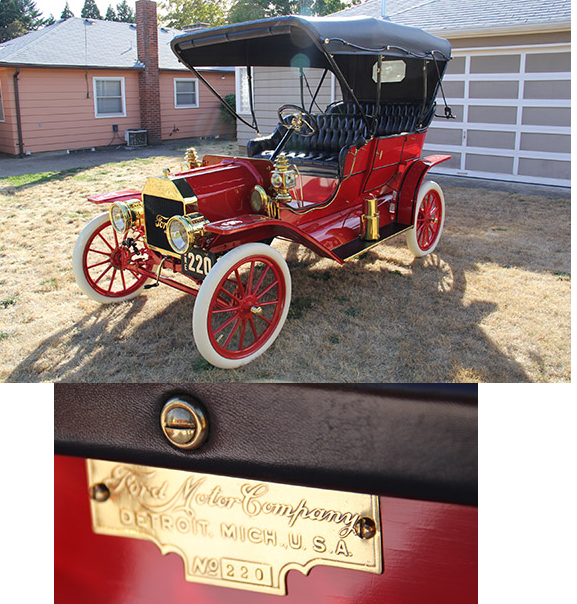

This subject comes up very often and I don't understand why a car is not dated by the sum of its parts i.e. the model it represents, rather than just relying on its ts engine number. In the end the decision of what year you want to have a Model T appear on a title is more of a personal decision than a DOT one and may affect insurance cost & claims.
Here is the example of much controversy, mainly because there was little documentation, provenance, maintained over the life of the vehicle. Just hearsay evidence. So this "restored" vehicle has been claimed to be an "original" with engine #220. If you accept that the engine is "original" do you accept that the body is also "original" to the car or just and original body or does it matter . If it matters then explain how it meets that criteria.
