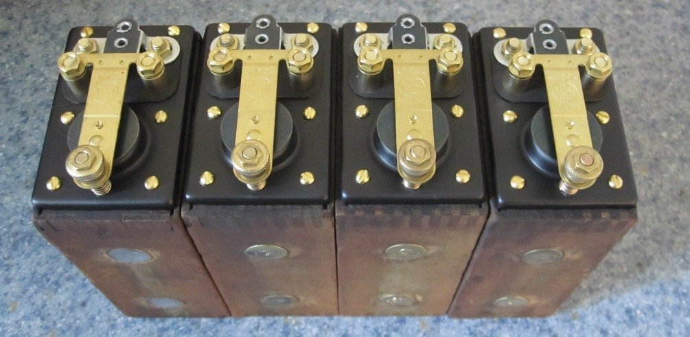

Yes a 1915 Model T would have had brass top coils, but there are some variations based upon date and who actually manufactured the ignition coils.
Ford made coils had six top screws and no plating on the raised metal stamping.
KW made coils had six top screws and the metal stamping was black anodized. The point mounting hardware is slightly different
Attached are examples of the variations.

Ron,
Who made the coils with the four screws like in your top picture?
Ron Patterson
Re: Brass Top Model T Coil
Post by Ron Patterson » Sat Jun 25, 2022 5:04 pm
Ford and KW
