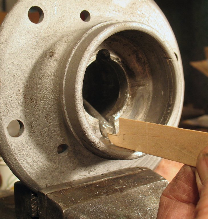

Unless you are extremely lucky in a parts search, Timkens are practically mandatory. Some ball bearing parts seem to be made of unobtainium. There's no problem with Timkens until you have to remove the cups from a hub made for ball bearings. The ball bearing cups have a higher profile and you can easily drive them out from the other side with a drift. A drift can't reach the lower-profiles Timken cup in an earlier hub without notches.
When I had new front wheels made for my 1915 I used 1917-18 hubs because they had the machined flange and three holes for a speedometer gear and were more substantial than earlier hubs so I had no qualms about adding notches.
Timken cup low profile.

Timkin races have a large radius that fits the T hubs. Modern replacements have near none & wont seat as deep as they should. Non timkin races can be machined/ground to fit, but its a pain. Even with timkin races the outer race typically sits proud slightly above the threads. Thats not generally a problem unless you are using repo hubcaps that are a little shorter than original ones. Check the hubcap to spindle end clearance.
