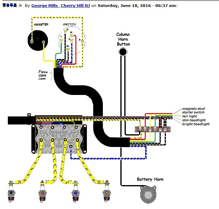

Even with an automobile that has a microchip, including the etimer, if a problem is detected, one starts with the ground. On the Model T, the whole frame is used as a ground.
Attached are pictures worth 3000 words showing the wiring and where the ground (negative terminal is located).

Re: No power from coils/no spark
Post by Moxie26 » Sat Jul 23, 2022 11:04 am
The ground in the electrical system will be where the spark plug screws into the cylinder head. Power up to that point is just switched on and off by the commutator and a vibrating coil which eventually gives that power to ground creating a spark
