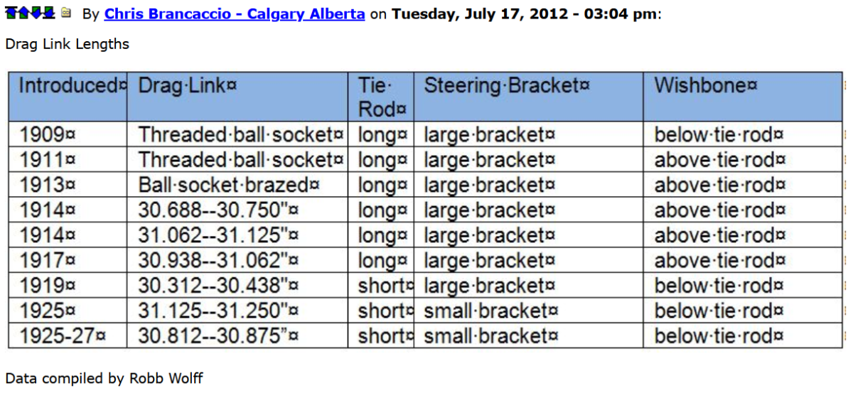

From a previous discussion

I addition to the above chart, the ends on the earlier ones were of a fine thread. Then they were changed to one end being fixed and the other on a coarse thread. Then came the riveted and brazed on ends.
