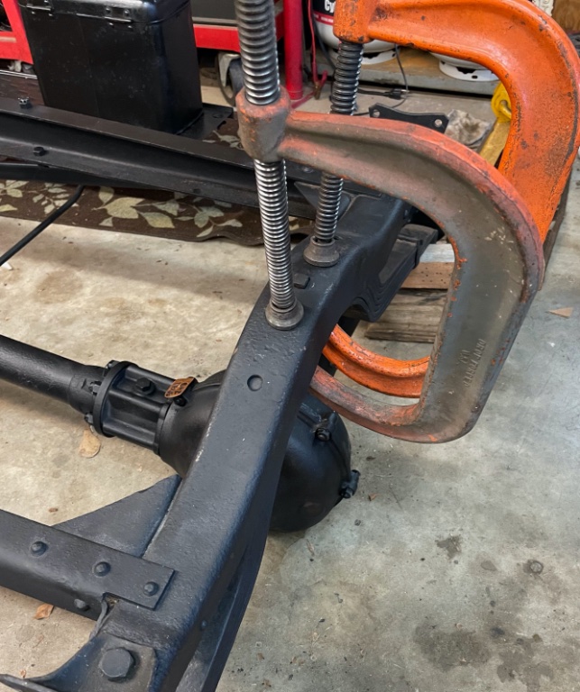

Lastly, don't forget the spring pad over the top leaf, prior to placing in the crossmember.
And be sure the crossmember channel isn't spread out over years, (esp. the front crossmember) as the spring stack should be snug in the channel, without any wiggle, needs to be secure there. Most times a mallet strike to seat the spring up there, or clamps are useful too for pulling the spring snug in place.
