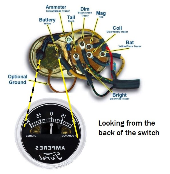

I have a non ford amp meter for my “t” which is showing charge with lights on Looking back in the form it says to reverse the wires my question is what wires do I reverse. A drawing would be great,a diagram is worth a thousand words
Thanks in advance
Bob
Reverse what wires

The ammeter has two wires attached to its backside. Move the right wire to the left side and the left wire to the right. That will reverse the flow of current through the ammeter so it shows charge or discharge correctly.

Re: Reverse what wires
Also check polarity of battery. Negative ground.
The non-Ford ammeters currently sold by vendors are for positive ground Model A’s Just wire it backwards and yer good
