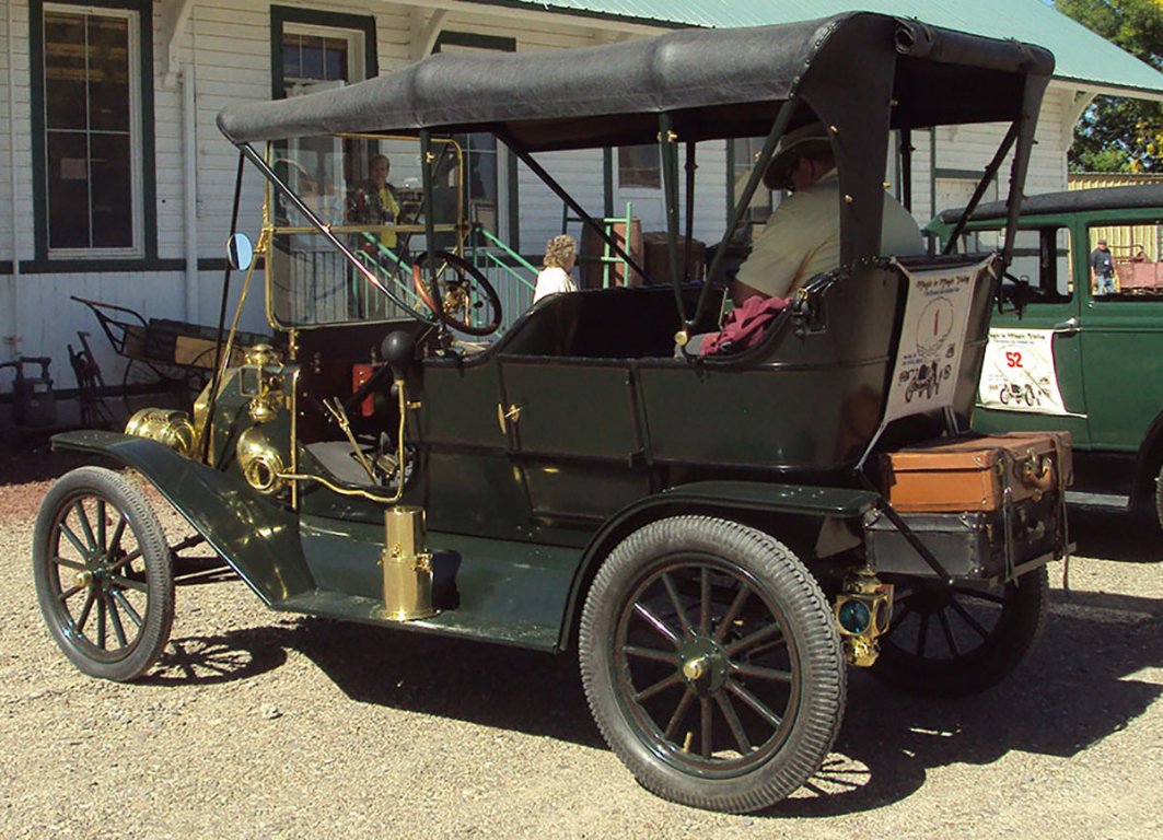

Looking at this photo the body does look satin while the fenders appear glossy.

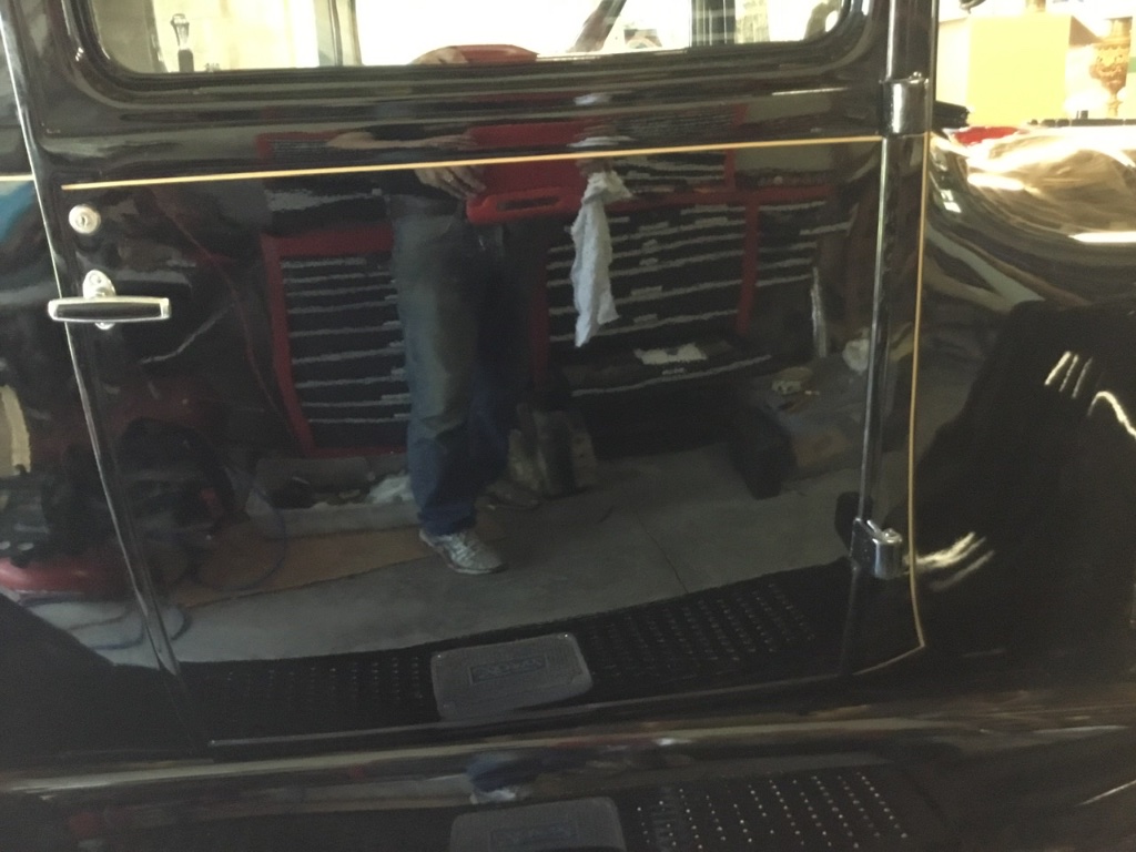

Here is a photo of a nicely painted 1927 Model T Fordor, which would have come off the assembly line like this with a Maroon body, black fenders and grey upholstery with thin maroon stripes. Your 1927 Tudor, which except for having 2 doors looks a lot like the Fordor, would have come off the assembly line with a green body, black fenders and grey upholstery with thin green stripes. Regardless of what Ford says, nothing is chipped in stone and it is strictly up to you as to what color or sheen you prefer. Since I like the maroon much better than the green, if I had a 1927 Tudor like yours, I would paint it the maroon, regardless of what Ford said simply because I think it looks better, will be viewed with much more appreciation by the public and may be more likely to attract interested viewers to get into the hobby themselves. Jim Patrick
PS. Imagine the beautiful highly reflective finish on the car below, as a dull, non-reflective finish and you can come to your own conclusion as to which selection is best for you and the appearance of your Model T’.

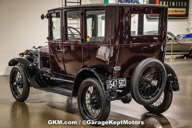

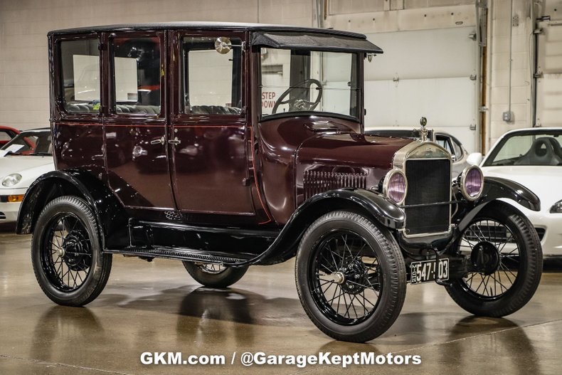

Re: Paint question

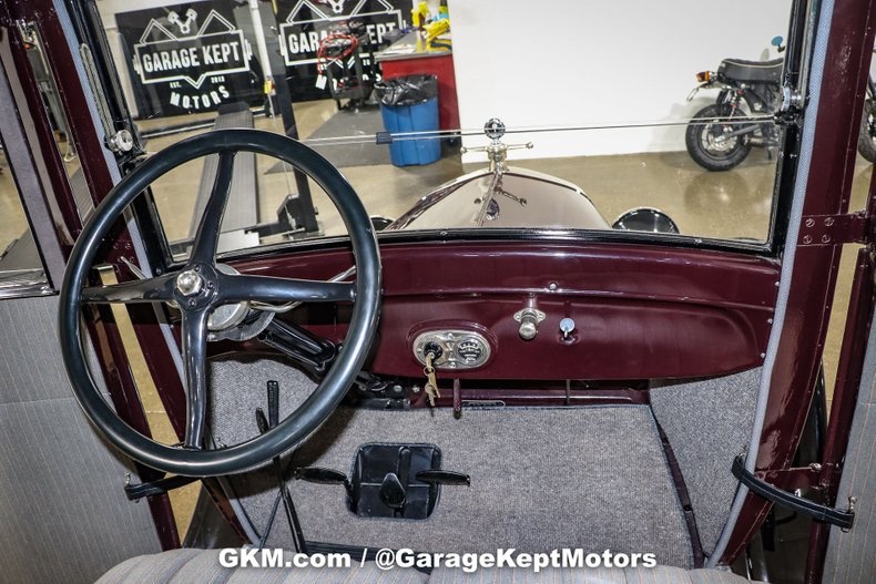

Here is a properly painted 1927 Model T Tudor for you to compare with the Maroon 1927 Fordor to help determine which color you prefer most. Jim Patrick
1927 Tudor painted maroon
1927 Tudor advertisement

Beautiful example of satin finish on body and gloss finish on fenders, windshield stansions etc

42 years ago in 1980, I sprayed my 1926 coupe with Imron, a 2 part gloss black epoxy that was made by DuPont and it looks like it was sprayed yesterday. Unfortunately, due to ingredients that were banned by the government, it is no longer made, which it too bad because it was the best and most durable paint I ever used. Jim Patrick
