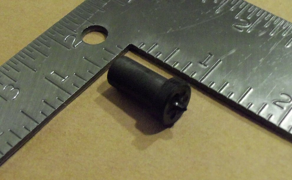

Does anyone know what the tool looks like to stake this type of rivet? These photos are from a '13-14 front side curtain in bad condition.

A normal tube rivet tool you are familiar with has a center raised tit.
The type that splits the tube has radiating raised edges. Looks like a daisy.
I have seen them in those large foot operated brake riveting machines.

They are called "Tubular Rivets". The shank is hollow to a certain depth depending on the thickness of the materials being riveted together.
The die used is called a "Tubular Rivet Setter" or "Splash Anvil" (see photos below). I bought one on ebay for $29 with shipping. It is for rivets with a 1/8" dia. shank.
https://www.ebay.com/itm/112173068097?h ... R7C7l7zbYA
The "Tubular Rivet Setter" can be used in an Arbor Press, or used by hand with a hammer, with a little finessing.
Here is a link to a youtube.com video showing how it is done. "How to Set Tubular Rivets in Leather".
https://www.youtube.com/watch?v=j2B64jbXezk

I received the new rivet setting tool pictured above yesterday. I'm glad I posted this question. I've been doing riveting all my life, and never heard of this tool. This is the real purpose of this forum.
