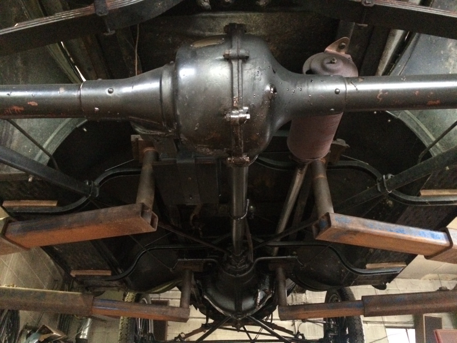

Took a little finagling, but got my 24 on my lift today. Changed the rear end lube, pretty thick stuff for a Ruckstell. I sucked it out slowly with a suction gun and filled it with 85W140, I think I'll run it a while and change it again.
Found some "manhole" oil cups for the rear shackles.
Found the left kingpin bushings are worn. (Next on the to do list).
Best thing is...I dropped the engine cover and found I didn't get #4 rod tight enough, rattle was more noticeable. I took the shims out and she sounds like a new one again !!
No drippy in the face on the lift, (a little on my shirt lol). Got one tire on and will mount the other later today I hope.
