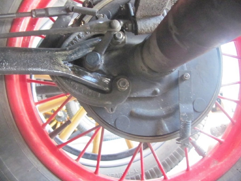

Somewhat normal to have that 1/8" gap. Wouldn't be concerned about gap, in fact would be more worried without a gap for resulting impingement on the backing plate. :shock:
Install with new axles, but with used good hubs. Brake drums are stock good used Ford. R-M brakes on the '27. You can see some gap in each install.
This one is used good axle and good hub, still some gap.
New axle and good used small drum and good used hub., Install show R-M brakes too
