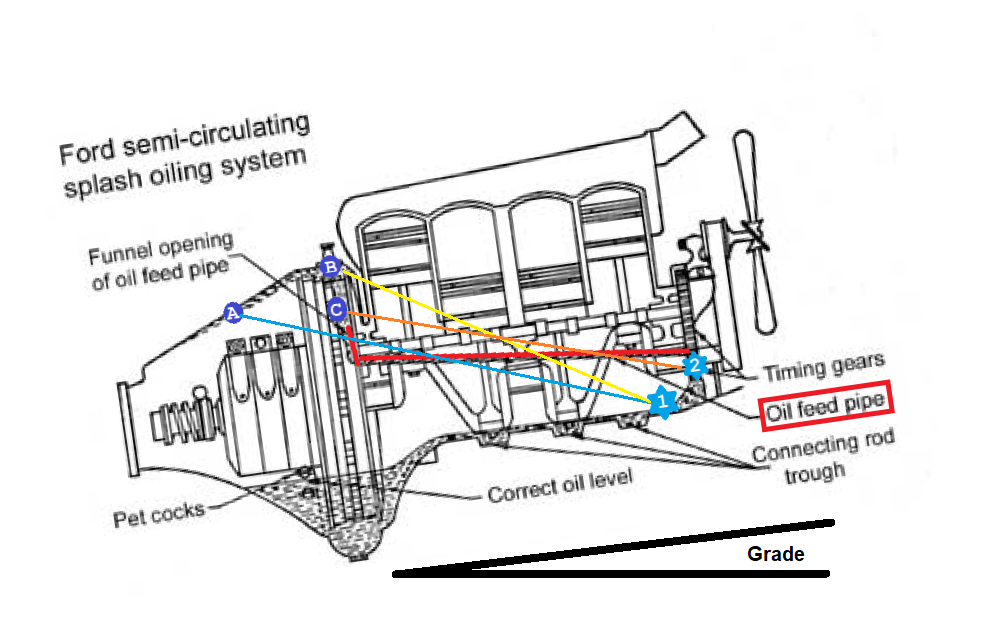

The reason for the outside oil line is to provide extra oil towards the front of the engine to accommodate Ford's splash oiling system when traveling up a steep grade.
While there are several outside oil line designs, it may be best to answer the question "which is best" as two separate questions. First, when viewing the engine on an incline and consider that the oil flow would be dependent on the amount of pressure (push) the pick-up system could provide & gravity (points A ,B or C). Secondly, where would the best place be to delivery the oil points (1 or 2).
Some pictures of where some kits were applied A = Ford Faithful, B = Magneto Pickup and C = High Volume. The Ford Faithful incorporates a transmission oil screen while the others could purchase one separately.
There isn't much of a grade before the inside oil feed pipe is at horizontal.
To overcome gravity the question is higher better (B & C) or the volume of oil available to deliver being further back & lower (A). Then which system would provide more "push" to get oil up the tube.
Then the point of delivery would be best the higher and further forward the connection. Point 2 vs 1
