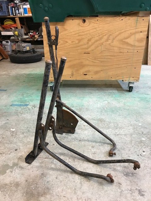

Post by CudaMan » Sun Sep 25, 2022 8:19 am
Some have converted their Ts to hand controls in the past. :)
