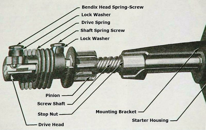

Picture of Bendix parts. So was the starter cover removed before or after the missing parts were noticed? If a screw and/or lock washer is missing which ones?

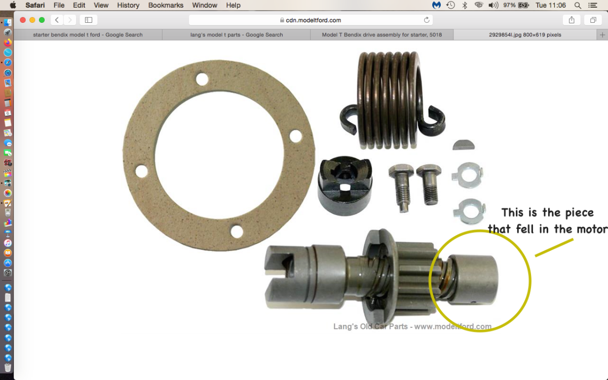

Thanks for the replies. I’ll provide a visual when I’m on my other computer. It shows the part that I believe is missing. The club member who was helping me troubleshoot the starter had a complete bendix and we compared the two after removing mine. Gerrit

Here is a photo of the bendix from the catalogue. We compared mine to a complete unit we had on hand and saw that the end piece that threads on was missing. I have to address the incredulous comments here and add that my friend and club member helping me had never seen this happen in over 40 years of working on and owning Model Tees. First time for everything, I suppose.
What prompted this whole adventure is one day the starter would just spin when I hit the starter switch. I could hear it turning but it was not grabbing the flywheel. I tried the usual things, thinking maybe it had hit a bad spot on the flywheel ring gear before taking the bendix off to further investigate.
Hope this helps clarify the situation. As always, thanks for the help.

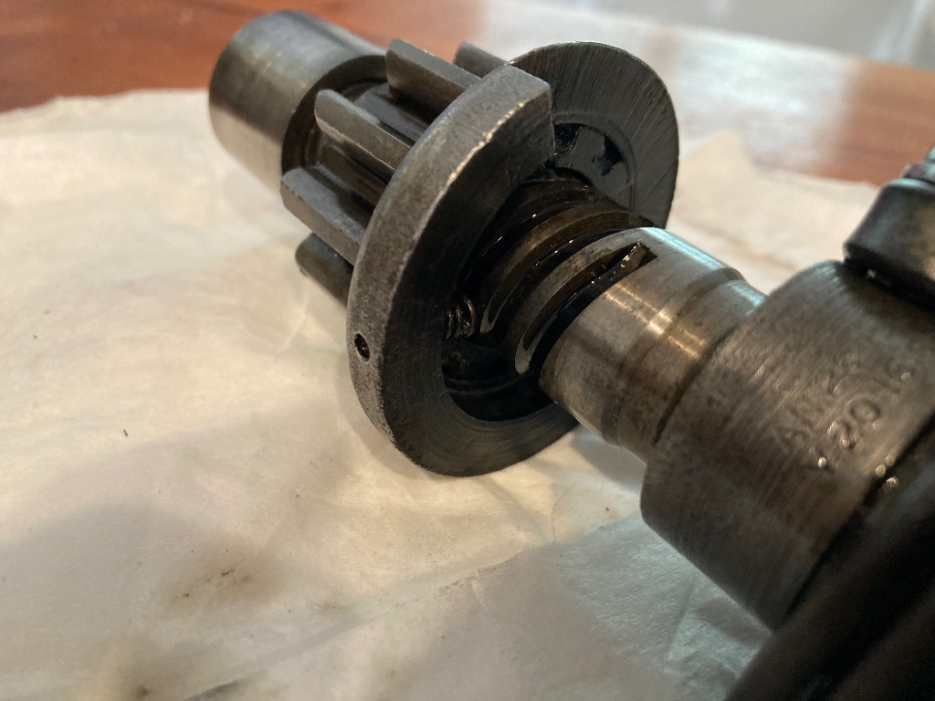

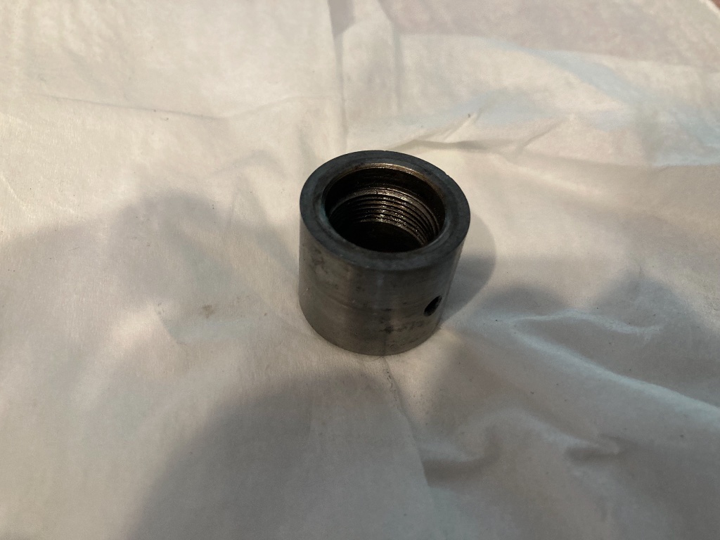

Is this the part? It came out of the starter, and it looked like the starter shaft was riding in it like it was some kind of bearing. If this is what I've been looking for you've saved me a tremendous amount of time and anguish.
THANK YOU.

That’s great that the piece was still in the starter snout!
Now to try to get to the small piece that was on the end of your flex tool!
Since it was a magnetic part it may be stuck on somewhere on the flywheel or the bottom of the engine sump.

The bendix would have still functioned, but this bushing supports the starter shaft. The starter shaft is likely bent & the ring gear teeth could be damaged from the flexing shaft & gear slipping. There would be nothing else lost in the motor unless the threaded portion of the bendix body broke off. (not likely).
That bushing has 2 holes on opposite sides. Those holes receive a stake from inside to retain onto the bendix body. Screw it back on tight & restake.
The old unit may be salvageable.
In the counterweight on the gear, there is a small counter-bored hole that retains a small pin & spring. It must be there for the bendix to operate properly. Did you account for it, if it was not in place?
Yes, the little pin and spring are in place. Checking it over further, I see the half-moon pieces inside the big spring and the corner of one is slightly galled. How do you feel about that? Going to cause problems? I’ve attached a photo, not sure how clear it is. Thanks for your time and suggestions.
Gerrit
I am thinking a special tool is required to stake that bushing from inside—or a lot of creativity and imagination.

Picture of the damaged bendix. Should have been attached to previous message.
Gerrit
Posts: 5254
First Name: john
Last Name: karvaly
Location: orange, ca
Re: Retrieving loose parts in motor
Post by speedytinc » Mon Oct 03, 2022 12:56 pm
Looks like a little burr. Remove the chip & you are ok.
Remove the spring, Inspect that part for a split & see the pin & spring which I cant see with this pix.
Post a better, more complete view.
Posts: 5594
Post by RajoRacer » Mon Oct 03, 2022 1:17 pm
Both spring eyes need to be in alignment - straight across from each other - I can't see your spring's other end. You should remove the spring to check for "common" cracks on the sleeve.
John stated the "crack" fact previously - sorry !

Additional pics.
Posts: 5254
First Name: john
Last Name: karvaly
Post by speedytinc » Mon Oct 03, 2022 2:01 pm
I see the pin & spring is present.
The large drive spring may need replacing. Normally the eyes line up together. Not to say there were not after market springs that were made with the eyes 180 out like your's appears. The spring looks a bit tweaked.

Here are all the individual parts to account for
Posts: 5594
Post by RajoRacer » Mon Oct 03, 2022 4:15 pm
Missing the small key in your photo.

Post by speedytinc » Mon Oct 03, 2022 4:20 pm
& a good view of the pin & spring.
