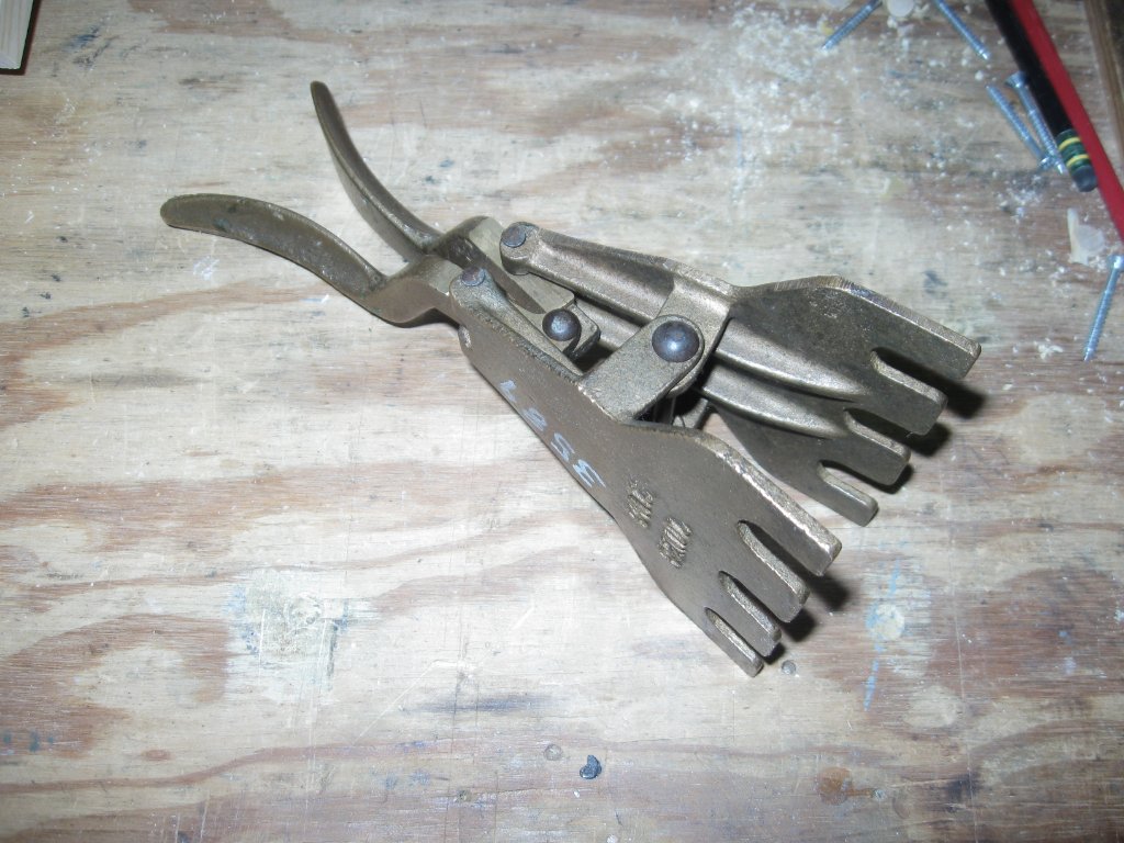

Oddly enough for me, this arrived in the mail this morning:
There is one of the Star spring compressors on Ebay. I came across the one in the photos while doing a search for some other things, it is not cast steel or iron (don't know what the original Star was made from), instead it is cast bronze. It should hold up well and I will happily give it a try instead of my Briggs and Stratton valve spring compressor that I normally use (always works well, but only does one spring at a time). How could I go wrong for a $9.99 bid?
