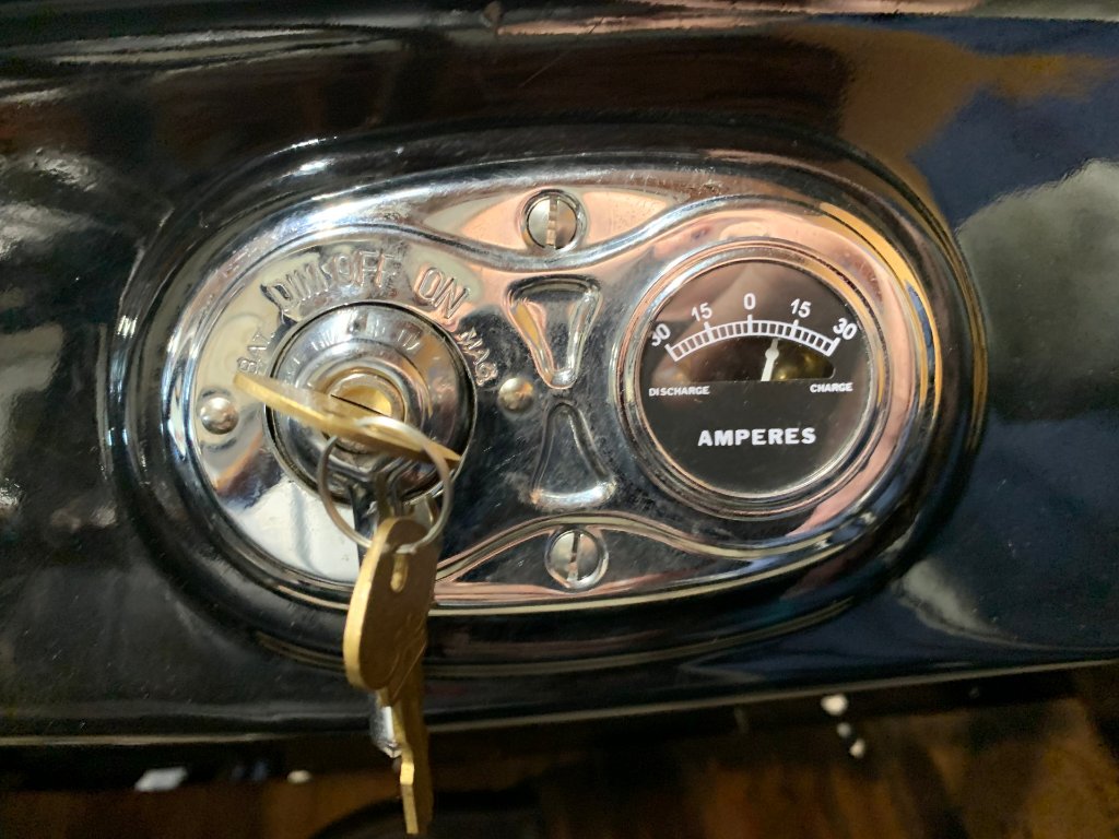

Finally yesterday I saw the results I've been hoping for! I bought another new alternator (I haven't been able to get the other one back - long story) and put it on.....but first, someone suggested that I should run a ground wire to the engine. The car came to me with a ground wire from the starter to the body frame. The car always started fine. Maybe the previous owner knew something? This time I ran a #10 ground wire from the battery negative frame mount up to the Hogshead and from there over to the front of the generator mount, fastening it to one of the alternator bolts. That did it! I know that Henry Ford wouldn't have said that was needed, and when the car was new it probably wasn't. It seems to have been what the car needed. So, thanks for all the advice on this one. Hoping my next issues will be much simpler!

Congrats, so you bought an alternator instead of a generator correct? If not, in my honest opinion the amps as shown on the amp meter is still a little high, you’re at 8-9 amps at speed. Typically, I’ve been told and have done so myself, you should be at 5 amps as not to reduce the life of your battery. I may be totally full of hot air. I’m happy for you though, thought you were going to leave the community, glad you’re not.
Thanks! I was just waiting till I had some good news. These cars really get to a person! I don't know how many times I've thought about getting rid of it and getting something a little newer, but I keep coming back to....'I have a Model T'! They're really fascinating and fun.
Yes, it looks high to me, too. The car hadn't been run in a month and it took a bit to start it up so I'm wondering if it was making up for a low battery? This was sitting in the garage for....maybe 5 minutes. What can be done about this?

All I can at least tell you is when I stsrt my Fordor which also has an alternator and new battery, it charges for barely a minute at 6-8 amps and quickly falls off to 1-2 amps and stays there all day. Even with lights, signals, etc. That's why I love my alternator. Power when you need it!

If it’s an alternator I get the amp rate if you had a low battery and the alternator is working to fully charge it.
As Tim said it should drop significantly once you meet the charge no charge threshold. Again congrats I’m really glad the catguy has 8 lives left. Best John
