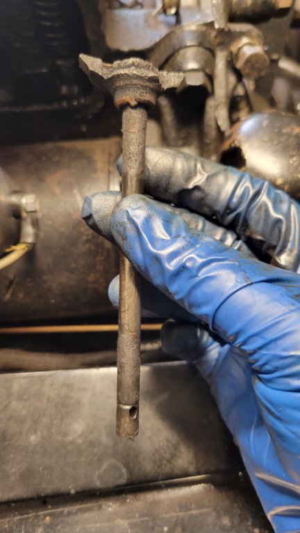

Topic author - Posts: 216
- Joined: Thu Oct 06, 2022 8:42 pm
- Last Name: A
- Location: Pennsylvania
- Board Member Since: 2022
Re: Just adopted a T - It was supposed to be a quiet project
I adjusted the 3rd brush. It is very sensitive. This was as low as I got it. It seems like if I adjust it any lower it falls to zero on the amp meter.
BTW, I don't know how old the wiring is but it looks old.
No lights:
Lights on:
Thoughts?

I drove my son around our neighborhood having a good time. I dropped him off at home and decided to do one more trip around the block before it got too dark. Everything was fine until it wasn't. Luckily I was about 100 yards from home when the car's power dropped. I was able to get it into the garage.
Cylinder 2 was dead... Uh Oh...
Pulled the spark plug and saw this:
Well, that's different. I just checked the gap on this last week. I googled reasons the gap could disappear and the results were not encouraging. I broke out the scope and saw this:
Uh Oh...
Time to pull the head... I was planning on doing it once it was too cold to drive anyway. Of course I got some help.
Funny, the other problems with this car aren't as concerning anymore...
My son had fun anyway pulling the head, and he didn't seem discouraged one bit that we have some work ahead of us before we get back on the road.

The old 3 piece 2-piece valve routine. At least you didn't lose a piston and didn't beat things up.

The valve itself is no loss. I don't see any damage to the cylinder, and the block looks like corrosion is less than average. I'd replace all the valves, springs, and keepers and make sure the new ones are seated properly and adjusted properly. Check valve guides for excessive wear. Oversize stems are available if needed.

Got the culprit out...
No damage to the seat... yay!
- Posts: 4236
There is damage to the seat. Maybe not from the valve breaking, but it's pitted and appears rusty. At the very least, it needs to be reamed.

A couple of updates happened to the T this week. The big one was replacing the intake manifold gaskets. I had the crushable copper ring gaskets with the separate glands that we put on when we reinstalled the engine but I was pretty sure I had a small leak based on performance and a little testing. I replaced them with copper gaskets that have the gland ring molded in.
This worked nicely. The seal is complete and performance has improved.

I was tightening the original spark plug nuts on my autolites just about every ride until a friend recommended the brass ones from the vendors. I thought they were just for show but now they are nice and tight after quite a few trips. This can only help performance.
- Posts: 440
- First Name: Miles
- Last Name: Bowen
- Location: Brighton, MI
Re: T adoption - My project progress
My aluminum spark plug nuts work fine as long as I give the terminal a little push in the tightening direction while tightening the nut. You can feel it tighten up.Arbs wrote: ↑Tue Sep 12, 2023 5:43 pmI was tightening the original spark plug nuts on my autolites just about every ride until a friend recommended the brass ones from the vendors. I thought they were just for show but now they are nice and tight after quite a few trips. This can only help performance.
Miles
