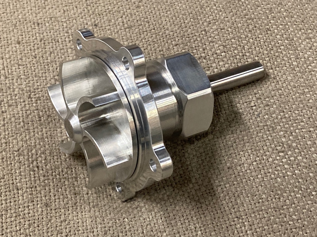

As if I hadn’t put enough time into this motor project already… this Boyd water pump turned up not too long ago, and it looked to be an actual centrifugal pump, and not just an agitator or circulator as many others are. After some deliberation as to how… it got a new stainless steel and aluminum front end. Next step is to drill a hole in a bucket, and see if my new pump actually pumps😬

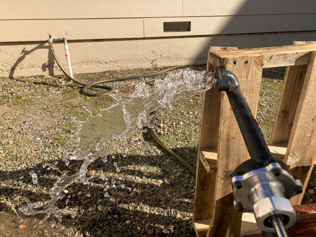

Well… it works!
My 2000 rpm drill pumped about 4 gallons out of the bucket in 20 seconds! With the pulley ratio, that should be about 12 gpm at 1300 rpm👍
I carefully excluded my testing rig from this pic as it was mostly constructed of duct tape😬

That sounds about right to me. That should give a capability of at least 8-10 gallons per minute at 1300 even allowing for some discharge head. That's 4 or more changes of the entire capacity of the block and head every minute. I'd think that's plenty. Too high a rate can cause an excess pressure drop on the suction side giving rise to cavitation and steam bubbles.

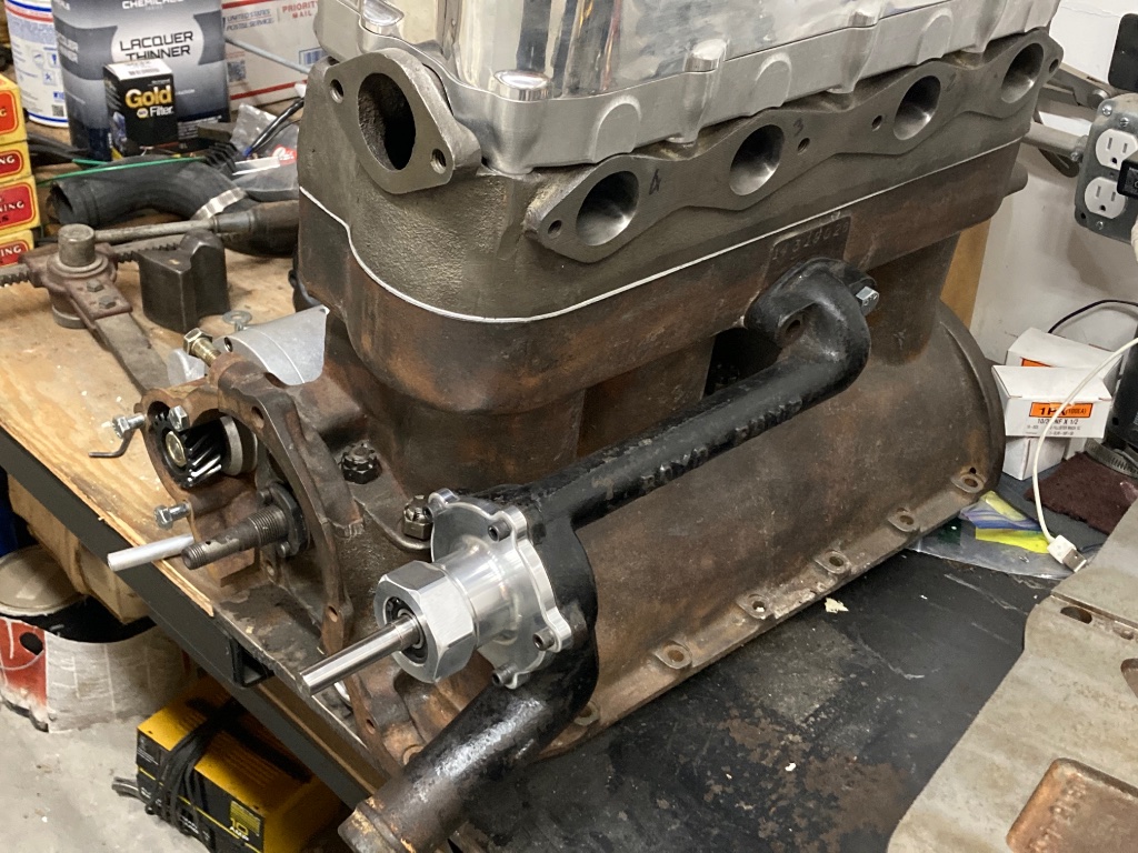

All that’s left now is to figure out how to tap into the water pump to supply the Fronty water manifold. I just ordered an assortment of fittings and tube to see what I like…

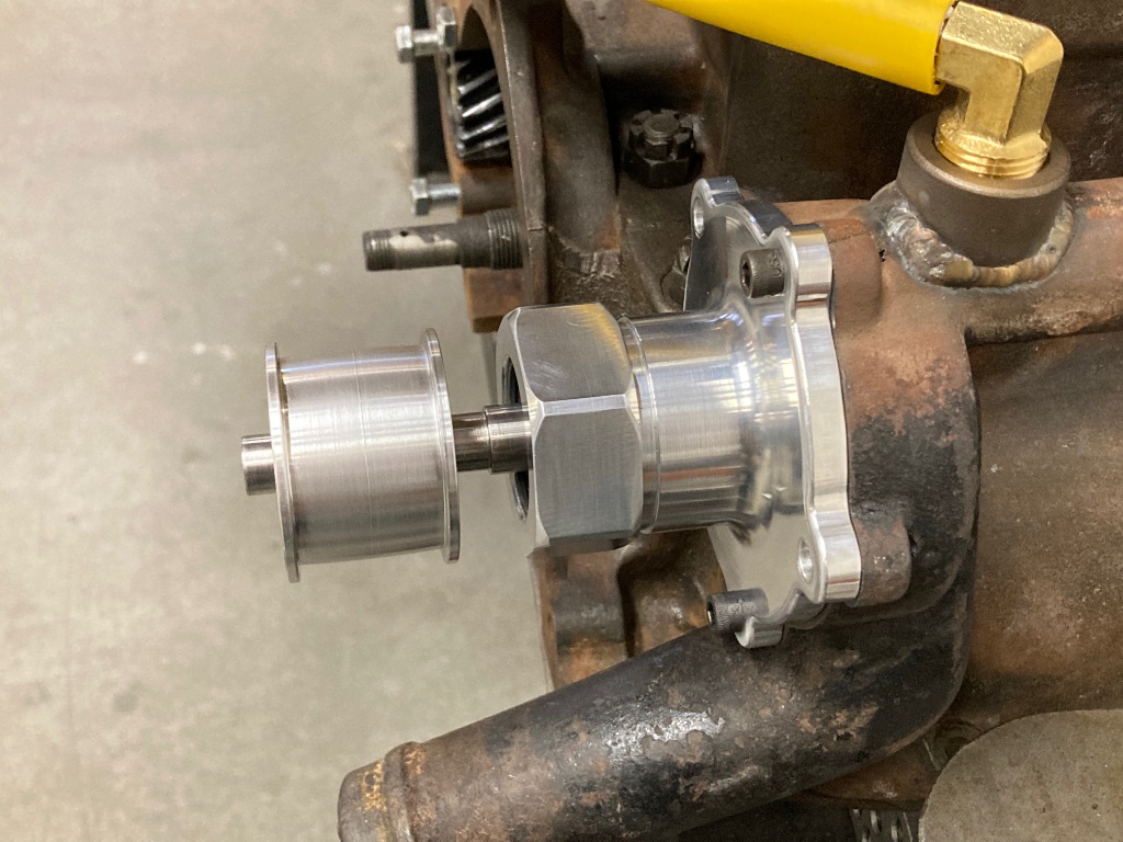

After several phone calls earlier this week… turns out that a water pump pulley is not available off the shelf. A drawing has been made, and will be ordering tooling next week. This will be one of the easier projects so far… but an unexpected task

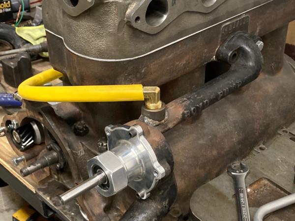

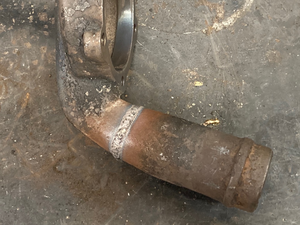

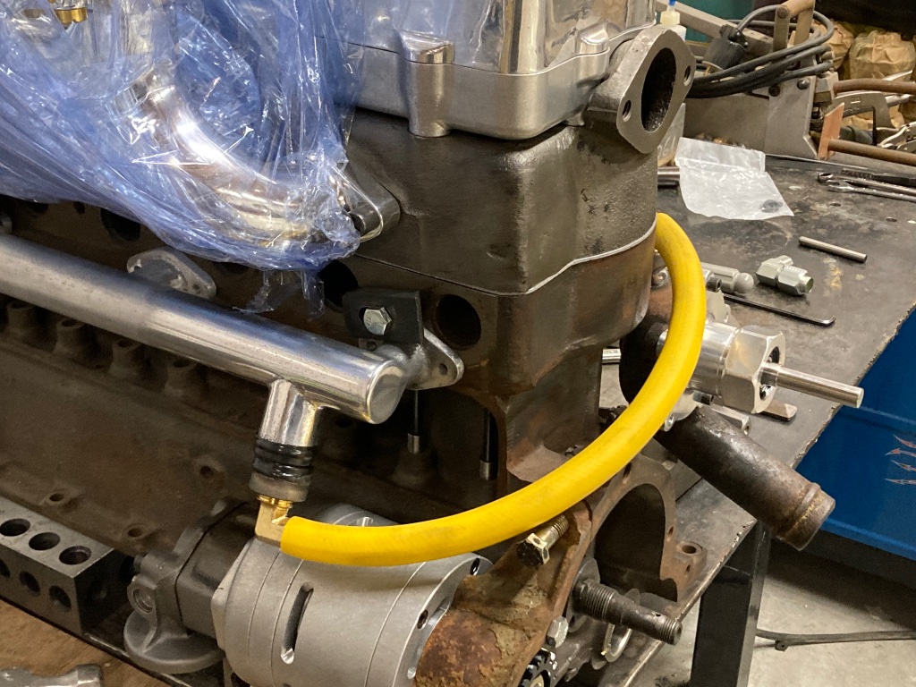

With all the festivities behind us, I started lookin at the water bypass fitting. I ordered a couple 1/2” pipe “bungs”, the idea was to connect one to the Fronty manifold with a short piece of hose, and weld the other to the water pump. Wasn’t sure if I would be able to get a 5/8” OD hard line bent to fit around the front of the motor, so ordered a flex hose as a backup plan. Didn’t realize it would be bright yellow…!
The bung is stainless steel and was TIG brazed with silicon bronze filler rod. Oh yeah… got bored yesterday and started polishing the water manifold🙄

Post by Kevin Pharis » Thu Dec 01, 2022 7:48 pm
I’m runnin out of excuses…

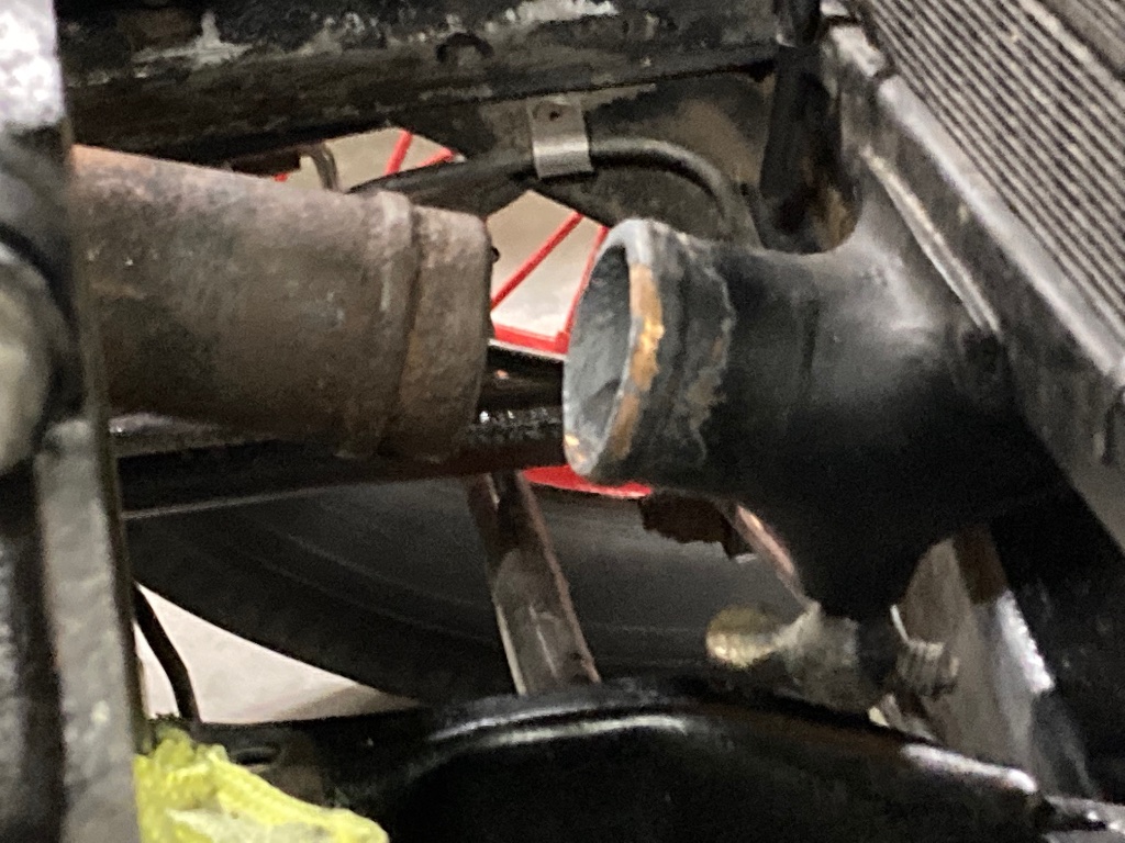

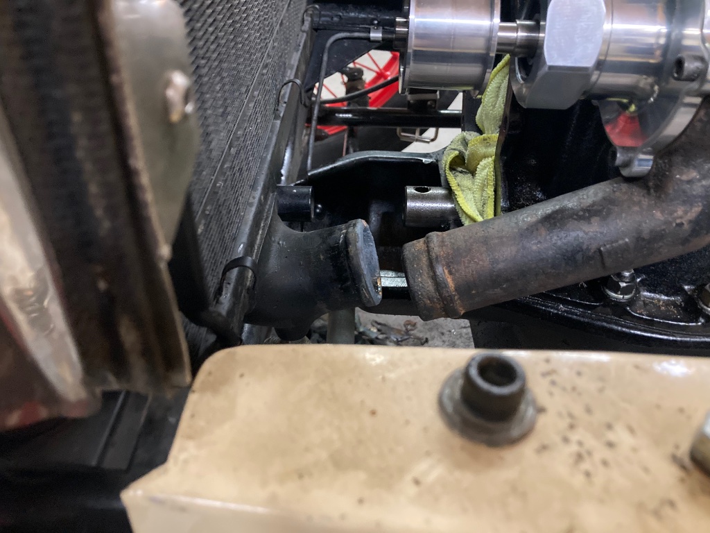

Post by Kevin Pharis » Sun Apr 02, 2023 11:41 pm
Of all the possible complications… the water pump inlet is more than 1/2” lower than the radiator neck! There is enough slop in the mounting bolts to get it within 1/4”… but the shaft becomes waaaay out of parallel with the crank pulley, and I fear never ending belt problems.
So am considering either cutting the pump housing back a few inches to allow the hose room to align, or wedge cutting the casting to angle the pipe into alignment with the radiator…
Posts: 7693
Re: Water… pumping…?
Post by TXGOAT2 » Mon Apr 03, 2023 9:22 am
I'd be inclined to modify the pump inlet to the correct angle. If you can get set up so that the pump will develop some overpressure in the block and head, it will be a good thing. It won't develop enough pressure to do any harm, and the more pressure the pump discharge sees, the less HP it will draw. Overpressure in the block and head will act to limit steam bubbles forming around the exhaust valve area. You do not want low pressure on the suction side of the pump. It may cause bubbles to form in the hot coolant. Throttling the coolant flow coming out of the engine via a thermostat or other restrictor will act to hold some overpressure on the block and prevent excess low pressure, or "suction", at the pump inlet. Ideally, you'd have a radiator capable of holding at least some pressure.

If you find there is too much flow - It is standard practice on industrial centrifugal pumps to trim the impeller diameter to obtain the desired pressure/flow required. It would be easy for you to make a spare impeller to experiment with. Centrifugal pumps are also pretty tolerant of restrictions in the discharge piping system. Somewhat counter intuitively, for any given centrifugal pump at a fixed speed it requires less horsepower to deliver a reduced flow at a higher pressure than a larger flow a a lower pressure.
As others have said multiple times, wish I had a small portion of your capabilities and talent. Well done

Thanks for the input fellas, I am far from a pump design engineer and based the impeller off the impeller that was included with the pump. The cooling system will remain basically stock, and intend to throttle back the pump if needed. Increasing the pulley diameter and cutting the impeller down are both options…
Posts: 7693
Post by TXGOAT2 » Tue Apr 04, 2023 12:01 pm
Slowing the pump down, if needed, would offer the opportunity to speed it up again if the need arose. Slower pump speed would also reduce any tendency toward hot fluid cavitation insiude the pump, while reducing wear rate. Throttling the pump at the engine water outlet, if needed, is probably the best way to regulate the flow rate.

Kevin Pharis wrote:
Fri Nov 18, 2022 5:06 pm
Well… it works!
Red Green would approve.

Post by Kevin Pharis » Sat Apr 08, 2023 10:46 pm
A little cutting, grinding, some heat, and a bit of silicon bronze TIG brazing rod…
Kevin Pharis
Posts: 1594
First Name: Kevin
Last Name: Pharis
Location: Sacramento CA
Post by Kevin Pharis » Sat Apr 08, 2023 11:11 pm
Waaaaay better!
