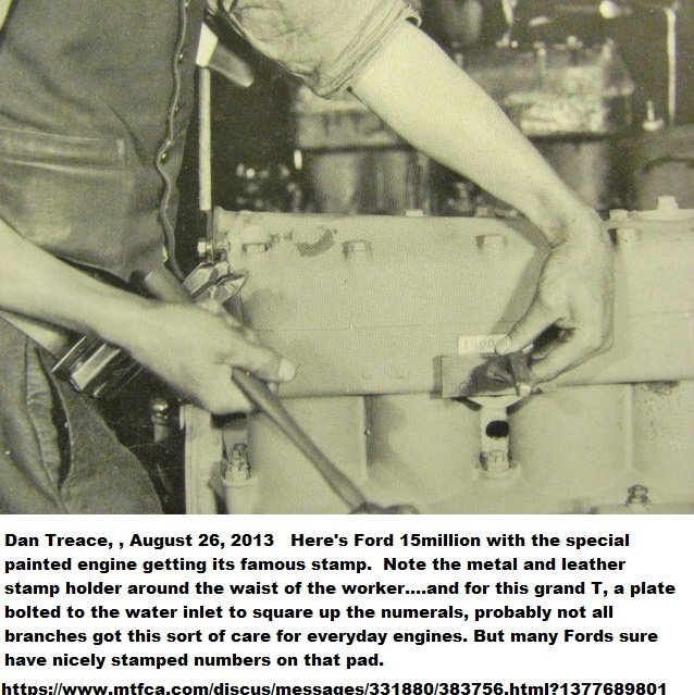

Someplace and sometime ago, I saw a photo of the device used to stamp the engine numbers.
The handle looked like the handle used to lift the round lids off a cook stove to add more wood.
The other difference was a rectangular slot that would hold 8 3/8th inch square number stamps.
There was a thumb screw on the end that would lock them in place once the correct number was selected.
I have never been able to find that photo again.

- Posts: 6537
Re: Anyone Stamping Firewall Data Plates?
Found this while searching for the stamp holder https://www.mtfca.com/discus/messages/3 ... 1377689801
