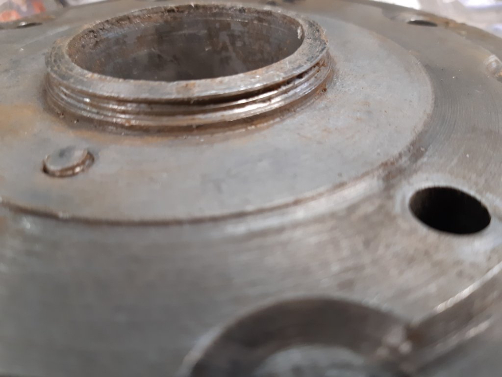

Topic author - Posts: 148
- Joined: Sun Jan 06, 2019 5:30 pm
- First Name: Jeff
- Last Name: Lee
- Location: Nova Scotia
Re: Differential case repair questions.
Here are some pictures to try to show a bit of what I'm working with.
The picture which has both sides of the differential case has a non-matching "top" on it from another one. But hopefully you can see how much the bottom half (crown gear half) has had the spider pin hole worn oval.
The other pictures are examples of the wear damage to the thrust washer collars and how much wear there is in the axle gear hole with a gear placed inside the hole.
A friend had some mechanical tubing of about the right dimensions that I can make the stepped bushing out of. Made one so far for practice and to test my fabrication proceedure. Now to make a second better one based on some learnings along the way.
- Posts: 1152
- Last Name: Gould
- Location: Folsom, CA
Interesting. How are you planning to fix the stepped bushing to the crown side carrier? If I were doing the work, I would take steps to insure that the bushing would hold fast and not break free and either revolve or migrate outward against the roller bearing
Just a thought. If youre going with an interference fit, using a steel bushing, keep the tolerances very small to avoil breaking the carrier. IMHO, you'd do better making your bushing out of either 660 bearing bronze or phosphor bronze. Either will crush down easier when fitting without risking damage to the carrier.
