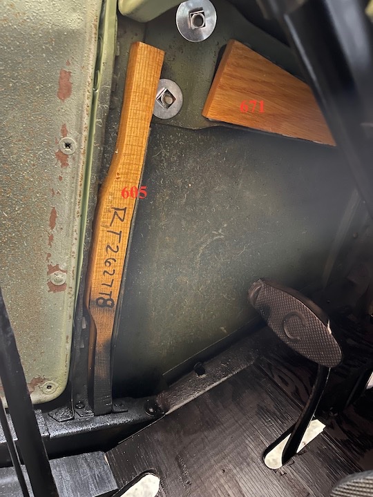

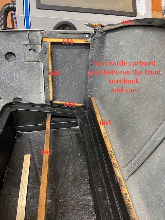

Now let's see where it all goes.

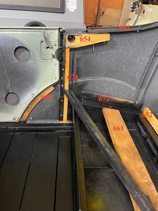

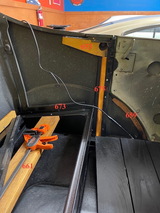

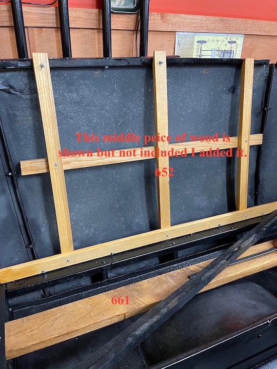

Now the back.
Now you will have to sand, file, shape and make the new wood fit the old body. But don't worry you'll never see it. I also stained the wood with Deck stain to protect it from water. The plastic tack strips are molded in with a heat gun.

Robert, did the 662 seat spring support board come with notches at ends to clear the metal frame? The Fordwood drawing looks like there are no notches. I made a board for my Runabout and I notched it to make the top of the board flush with the top of the seat frame.
My car also did not have the 605 and 606 boards. I made them but have not installed them yet. I don't think I have the geometry correct. The metal flanges that 605 and 606 fasten hold the kick panels about 3/16" away from the body flange. If I install the kick panels, there is a gap between them and the body where I can clearly see the wood blocks. The bottoms of the flanges (see the yellow arrow below) also curves outward and makes the kick panels stick out there. I was thinking of beveling the face of 605 and 606 to let upholstery nails bend kick panels to meet the body flange. But, there would still be a gap at the bottom due to the curved flanges.

Mark,
Yes there are notches on 662 to support the seat spring. I had to cut mine a little more to make the board flush with the top of the frame. As for the other ones that you made I'd just sand them down to fit. I had to do a lot of sanding and filing to get everything to fit. I bet when I start to put the interior in I'll have to adjust some more. I can only imaging how much these care have been through over the years. Seems like everything has to be custom fit. I should have paid more attention in wood class. Ha!!
