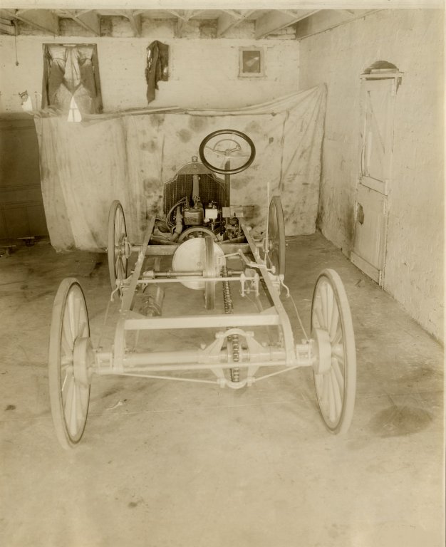

Did anything ever come about from that early friction drive chassis you were researching a few years ago? It was interesting. I find myself often wonder what became of it.
Ohh jeez, I hope we don't get in trouble for hi-jacking Dave's thread. :o :roll:
As to that car, I own it by default, ...but I don't have a clue what it is -nor does anyone else it seems. I would restore and tour with it but again, it had some cobbled up wagon body on it and so there is not much to go on to identify it. The irony was several people suggested the vehicle was likely just something that was a made-up vehicle for a movie or as a prop car in the 50s or 60. I was about to agree with them as I had no clue either, Then after the owner had passed and the estate was trying to be settled, some pix were found that are either the prototype of this vehicle, -or they ARE of this vehicle I have but with the wheels changed. That kinda blew the theory of a prop car to the naysayers. My wild guess is that likely it was an assembled car from the 1908, 09, 10-ish era that the 'assembler' used to try to raise investor funding for an automobile manufacturer start-up. Likely didn't make it too far into production though. Kinda hard to register it with the DMV or HCCA when you don't have a Make or even a year of manufacture to list. :lol:
