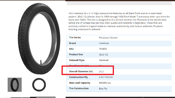

Perhaps we need to know what an original tire OD was when measured - not by the advertising numbers
From Blockley website 31.3" OD https://www.blockleytyre.com/product/30x3-5 --
From Coker tire for Firestone https://www.cokertire.com/tires/30x3-5- ... black.html

Those tire spec dimensions would be inflated off the ground. Even a 30 X 3.3 tire inflated to 60#'s looses height on the ground, as shown by Kevins tape measure.
