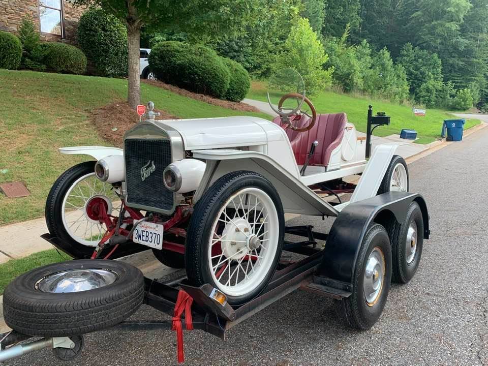

There are a lot of old threads about a multitude of Model T Brakes. I have looked at Rocky Mountain Brakes $869 and seems there are problems backing up. Of course drum brakes in the rain are about useless. But maybe better than the original "prayer" brakes.
What else is out there? I am much less than original/authentic than stopping power! I have seen disk brakes? Other ideas?
I have this sickening feeling that I may plant my Moto-Meter in something solid or even semi-solid mass to stop me!
I have a 1927 Hot (as in fast) Speedster. It has original brakes. What are my options? I know that skinny tires on the two rear will not stop me like modern brakes, but lets have a fighting chance?
Here are my rear brakes, now
Here are a few goodies that need to be stopped when needed!
Bill
