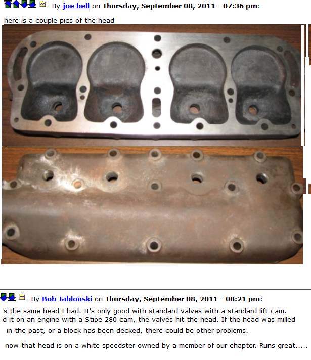

Does anyone have knowledge about this head. I hope that the photos do the combustion chamber justice. The part # is A-1-2011. Also has A.C.

Re: High Compression Head
Neat
looks like a Ricardo combustion chamber
will be very interested in hearing what folks know about it
Same combustion chamber as a Parker, but I don't know if he made his in cast iron.
That’s an A.C. accessory head. I’ve seen them on HIMICO engines.
Looks like Ed & I found different pictures & discussions for an A.C. Head. see image. While all 3 combustion chambers look alike the top of the Unknown head doesn't match that of the A.C. references. Doesn't mean it couldn't be an A.C. perhaps a different run or top designThreePedalTapDancer wrote: ↑Mon Jan 23, 2023 3:16 pmThat’s an A.C. accessory head. I’ve seen them on HIMICO engines.
I'm convinced it's a AC. Above the valves is so deep you would need 1" lift before even thinking of checking for interference. Thanks for the quick ID.
The spark plugs on the Himico engine Ed posted are well and truly recessed, just like a Ford head. It is not like the initial post.
I have ran this head for years on my Fordor, I like the combustion chamber and works really well for pulling hills in a heavy car, looks stock except no wells!
It would be good to know what the combustion chamber CC's to compare the displacement/compression ratio to other known heads.

Re: High Compression Head Spark Plug Info Needed
Found another one.
It may be my readers but those plug holes look like a fine strait thread & not a lot bigger than the head bolt holes? Has anyone tried to fit plugs
in the holes??
I'll sandblast it and report back.
Mark, your find is like the black one of Ed's. Note the recesses in the casting near the plug holes along the riser for the water outlet. There looks to be two different ones with similar combustion chambers.
I came across another one of these a couple years ago and it took the Model A plug instead of the A-25 that my head took.
Interesting that the valve pockets are so deep.
No cracks.  No carbon in pockets.  1/2" NPT
Mark, that is identical to mine!
Yes.  I believe it is one and the same.  It was rusty when found with no carbon deposits.  I believe it was never installed.  Do you still have the patterns?  It looks like it would work great with a very aggressive high lift camshaft with a little mill work.
