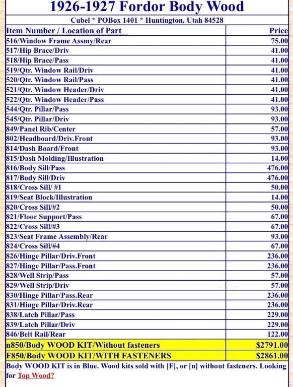

Morris it appears to be a Fordor which has significantly more wood in its skeleton than other 1927 models for a T.
I’ve got a 1926 Fordor & they are heavy T’s. Here’s a few pictures for the forum.

Wood pictured courtesy of Fordwood.com, I’d encourage you to make sure the wood is solid with little rot, if not run, run very fast.
