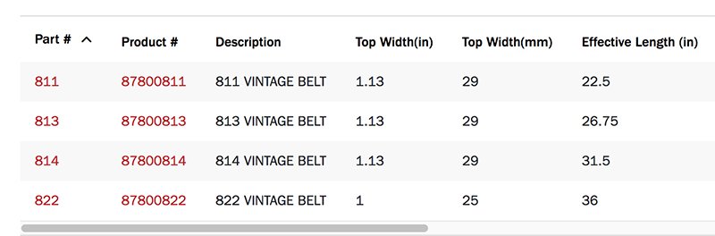

I checked the Gates site for Vintage Automotive belts. This is what I found:

I got an 813 for some reason!

That was an 816, not a 813 and now I know a Gates 816 is 28 7/8th inches long and will fit a 1916 to 1918 with a larger crankshaft pulley.
