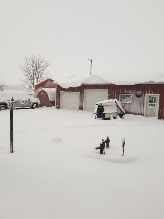

Nothing. Dealing with this today. A snow go kit would be fun now.

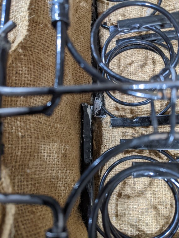

The seat frame in my Runabout is broken. It has always had a bulge in the front of the seat. I pulled the upholstery back and found the break. The perimeter frame ends were bent up and digging into the vinyl.
I straightened the ends and made a "taco" splint out of 16 GA. I crimped it around the butted ends. The reassembled frame is straight and comfy. I will replace that taco with a painted one when the weather is warm enough to paint.
