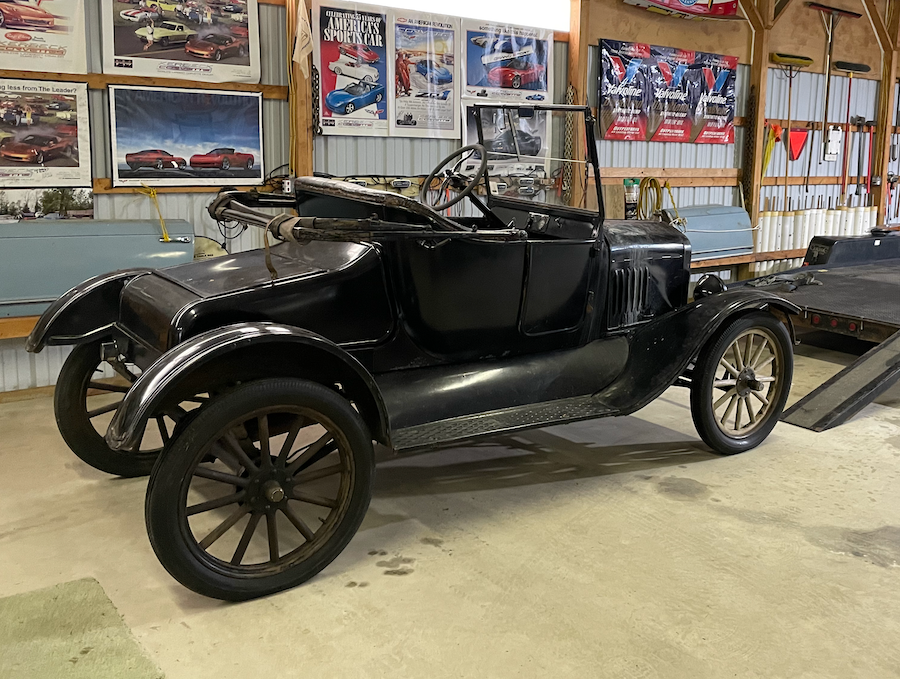

Re: WTB 24" Clincher Wheel
This is a picture of the T just after unloading. From what I could find out it hasn't run since the 60's. The dealer tag on the radiator also.
Looking at your car it looks to be a '24-5. So I have defined that much, I think I would look for a set of demountable wheels, including a 5th rim & a rear rim & tire carrier to match the 30x3 1/2 tires or go to 21" balloon wheels & tires as they became available later in the 25 model year.
