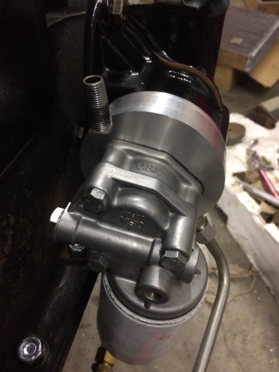

A picture I have handy!
The nipple on top is a priming location after an oil change.

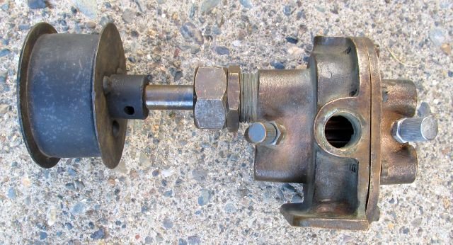

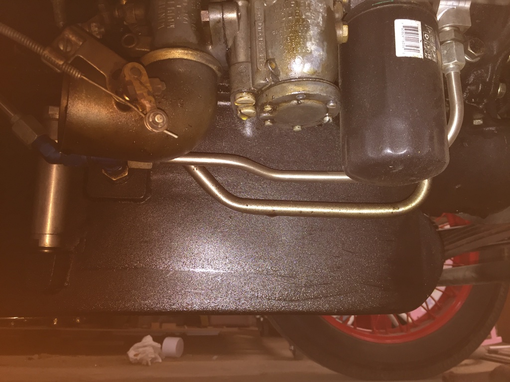

Just like Les, this is all I’ve got at the moment. What are you wantin to know…?
There’s a few things I’m not crazy about with the typical Datsun pump install, but doesn’t stop me from enjoying mine. I was hoping to fix a few of these with my recent alternator build, but haven’t been able to test the pump yet. I already know the alternator is low output at best, but the pump should work
