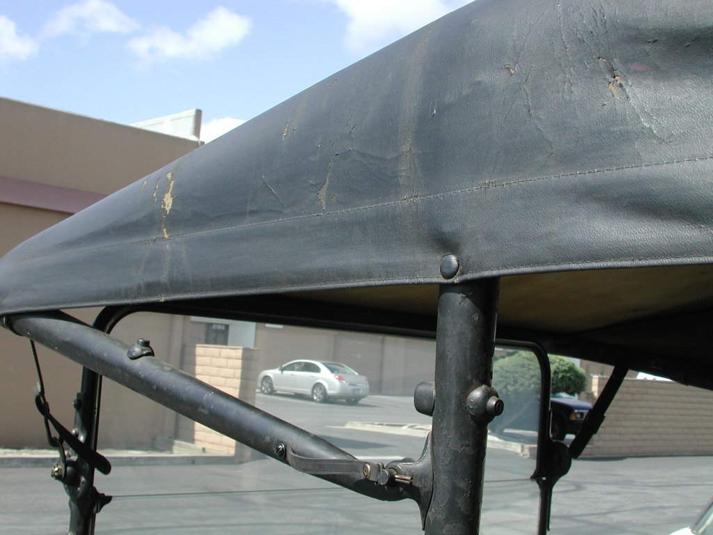

For the purists:
From the factory, the second top irons/sockets of a U.S. assembled 1916 Ford touring each have a single upholstery nail that goes through the top iron and into the wooden bow.
Below is a photo of the second bow of the original factory top of the "Rip Van Winkle" 1917 touring. The only difference between this 1917 factory top and an original 1916 factory top is the rear curtain - three rectangular lights vs a single tombstone light.
(I installed a new top on my dad's 1917 touring last year. I filled in the original upholstery nail holes in the top irons with round toothpicks and glue so the new upholstery nails would hold.)

Hi, Erik.
Because there is no wood behind the iron, this will nor work in my case. But thanks a lot for showing me. Meanwhile I decided to use a rivet nut M3, this is the best option.
