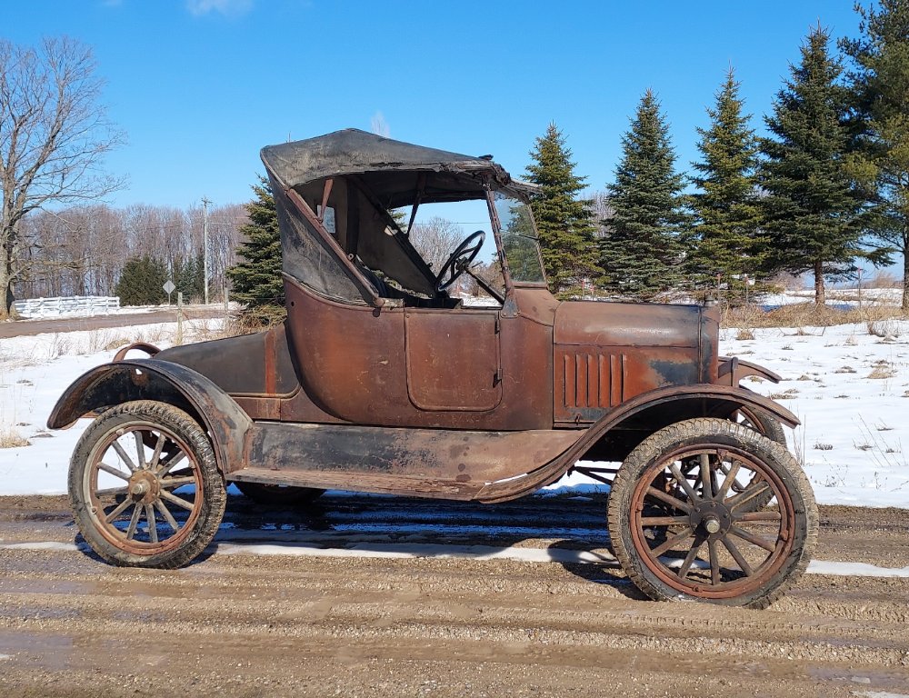

So I found some top sockets for my 24 roadster at the Marietta swap meet yesterday. It came with 1 rear set of sockets and bow, one center set of sockets and bow and two different lengths of front sockets.
One set puts the rear bow in line with the back of the seat and one set is longer and puts the rear top bow about 4 inches behind the seat back. I say behind the seat back with the top up, using a level to check for plumb it is 4 inches or so from the level to the seat back.
WHICH ONE IS CORRECT ? Where should the rear bow be in relation to the seat back when the top is up?

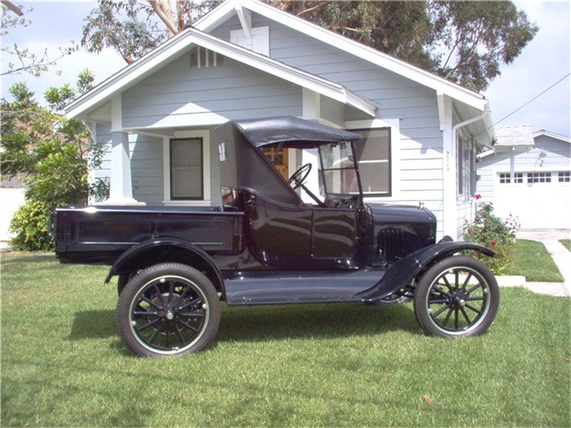

If you have a copy of Bruce's book, take a look at period photos of new cars to see what angle the rear curtain was at. The section on the 1925 roadster pickup has some particularly good pics. Here are a couple of pics of Larry Smith's 1925 pickup, if anyone would have taken pains to put the rear curtain at exactly the original angle, it would be him. Well done Larry! :)

The top should extend back past the rear of the body at least 2". Yes, study factory photos.
I figured for my 27 the overhang is 3.5" to match the body lines.(with consultation from fellow forum members)
Copying a "factory" 25 roadster P/U may not be the same. Angling the top back will interfere with stake bed sockets.
27 stake sockets are not @ the front of the bed. Changed some time in 26?
